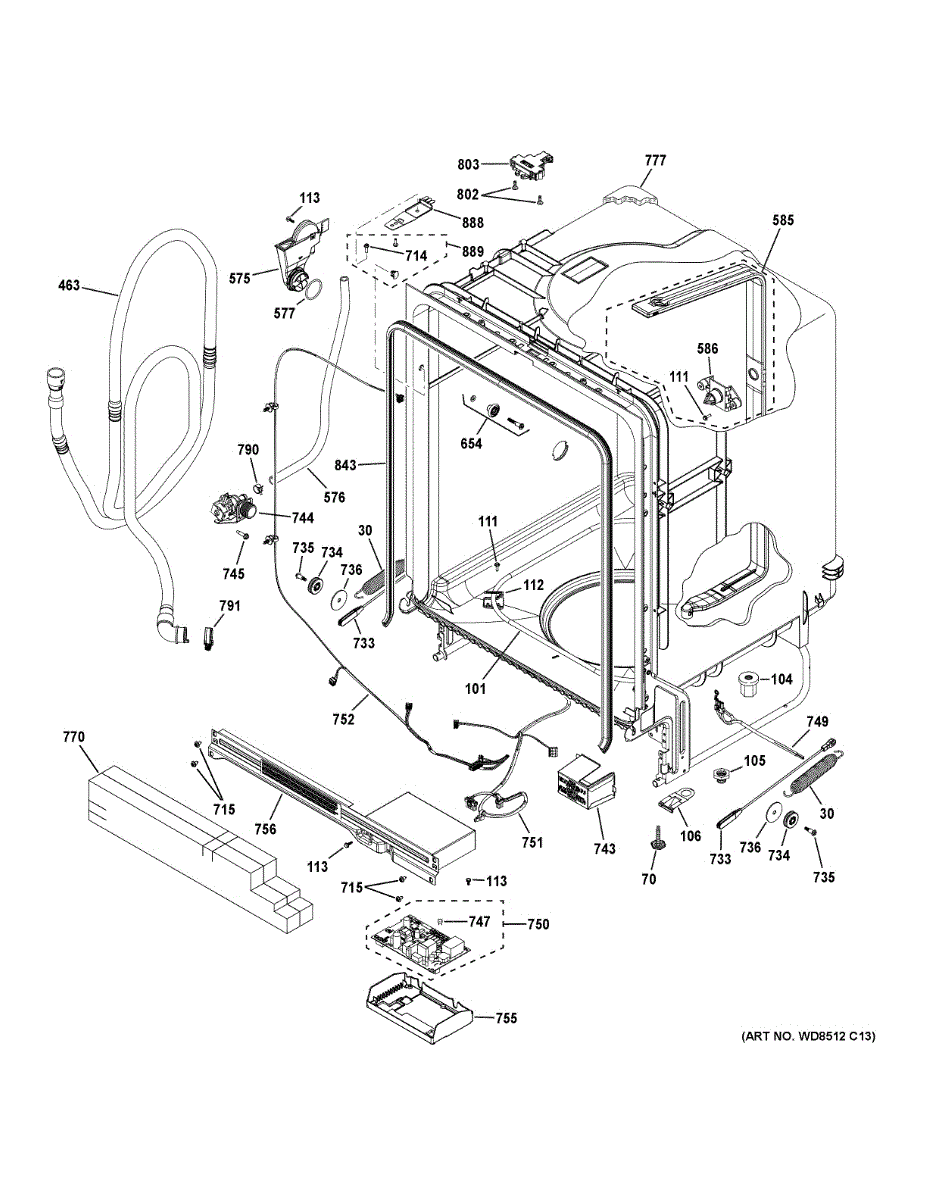

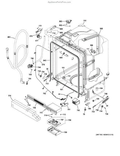

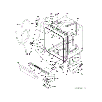

This dishwasher door spring counterbalances the door so it opens smoothly and doesn't drop. Replacing a fatigued or broken spring restores proper door action, prevents sudden slamming, and reduces stress on the hinges and link components.
  • Provides the tension that counterbalances the door's weight during opening and closing
  • Helps prevent the door from dropping quickly or feeling unusually heavy
  • Supports smooth, even movement within the door hinge/counterbalance system
  • Common signs of failure: door falls open, won't stay partially open, or binds/squeaks while moving
What's included: 1 door spring Install notes:
  • Disconnect power and shut off water before servicing; wear gloves and eye protection
  • Remove the toe-kick to access the spring and hinge area
  • Support the door; carefully relieve spring tension and transfer the spring to the same anchor points as the original
  • Test door balance and motion before reinstalling the toe panel
$9.53
$10.48
$0.95
70
4.9 (48)
The Bearing Slide Assembly is an OEM component for GE electric clothes dryers. As an integral part of the dryer tumbler system, this assembly includes the bearing slides that allow smooth rotation of the tumbler drum during drying cycles.
Symptoms of faulty bearing slides include:
  • Abnormal vibrations or shaking of the dryer cabinet
  • Noisy operation that gets louder over time
  • Rubbing or grinding sounds coming from inside the machine
  • Reduced tumbler movement or inability to manually turn the drum
Causes involve general wear of plastic bearing surfaces from years of drum rotation as well as potential damage or misalignment from excess stress on the slides.
This GE OEM replacement helps maintain balanced tumbler movement. Compatible with Hotpoint, RCA, and some Kenmore dryers using the bearing slide assembly design.
$23.95
$28.50
$4.55
101
The Heating Element is an OEM replacement part for GE dishwashers. It is responsible for heating the water during wash cycles and assisting in drying dishes at the end of the cycle. The heating element ensures optimal cleaning and drying performance by raising the water temperature and promoting evaporation.
Over time, heating elements can fail due to wear, mineral buildup, or electrical issues. A malfunctioning element may result in poor cleaning or drying performance.
Symptoms of a bad heating element include:
  • Dishes remaining wet after the drying cycle
  • Water not heating adequately during the wash cycle
  • Error codes related to temperature or heating issues
  • Visible damage, such as cracks or corrosion on the element
$46.95
$56.30
$9.35
105
This heater nut secures the dishwasher's heating element where it passes through the tub, helping maintain a tight connection and proper positioning. Replacing a damaged or missing nut can help prevent leaks and keep the element stable.
  • Fastens the heating element to the tub from below to hold it firmly in place
  • Helps support a watertight connection at the element pass-through when used with the proper seal
  • Replace if the nut is cracked, heat-damaged, stripped, or missing
  • Common symptoms include water leaking under the unit near the heater terminals and a loose or wobbly heating element
What's included: Heater nut. Install notes:
  • Disconnect power at the breaker and shut off water before servicing
  • Access the nut from beneath the dishwasher; remove the toe-kick and pull the unit forward if needed
  • Support the element from inside the tub while tightening; snug gently and do not overtighten to avoid damage
  • Restore power/water and run a short cycle to check for leaks
$7.37
106
$4.99
$5.35
$0.36
111
4.9 (15)
The screw is an OEM replacement component for GE dishwashers. It is used to securely fasten parts inside the dishwasher tub assembly.
Causes of a damaged or defective screw usually involve wear from continuous mechanical stresses and vibration during dishwasher usage. Loose parts affect machine balance and performance.
Symptoms of a compromised screw placement include:
  • Noises or abnormal sounds coming from inside the tub
  • Intermittent error codes related to moving components
  • Detached or misaligned spray arms or filters
  • Insecure tub fixtures that can be jarred with normal operation
This GE part can also be used on Hotpoint, RCA, and Kenmore/Sears appliances.
$1.79
112
This twist-lock clip secures the dishwasher's heating element to the tub floor, keeping it properly positioned for effective water heating and drying. Replacing a broken or missing clip stops rattles and keeps the element stable during cycles.
  • Locks the heating element to the tub/base with a twist-to-secure design
  • Maintains correct element alignment and clearance
  • Helps reduce rattling or scraping noises from a loose element
  • Common signs: element sagging or out of place, broken/missing clip, poor drying results
What's included: One twist-lock heater clip Install notes:
  • Disconnect power at the breaker and allow the heating element to cool before servicing
  • Remove the lower rack to access the clip on the tub floor
  • Rotate the old clip to release; position the new clip over the mounting slot and twist to lock
  • Ensure the element is fully seated in the clip and not contacting the tub or spray arm
113
$7.52
$0.84
463
Extension drain hose replaces a damaged or missing refrigerator drain extension to restore a secure path for defrost and condensation water. Properly routing drain flow helps prevent leaks, puddles, and water damage under the appliance. What it does:
  • Routes defrost and condensation water from the refrigerator drain outlet to the drain system or pan.
  • Restores a sealed drain connection to reduce water pooling or dripping at the rear or under the unit.
  • Flexible design allows routing through cabinet openings to reach the drain location.
  • Common symptoms this part can address: water puddling on the floor, recurring leaks, or slow drain flow causing interior moisture.
What's included: One extension drain hose. Install notes:
  • Always unplug the refrigerator and turn off the water supply before servicing.
  • Remove the access panel or toe-kick to reach the drain outlet; carefully disconnect the old hose.
  • Clear any clogs from the drain inlet (warm water flush) before installing the new hose.
  • Attach the hose to the drain outlet and secure with the existing or a replacement clamp; ensure a continuous downward slope to avoid water trapping.
$26.47
$29.41
$2.94
575
This dishwasher fill funnel guides water flow into the appropriate channel, helping ensure proper distribution during wash cycles. Replacing a warped or damaged funnel can prevent leaks and restore consistent spray performance.
  • Directs water into the dishwasher's internal water feed path
  • Helps maintain correct water pressure for spray arms
  • Common failure signs: leaking at the funnel area, poor spray performance, residue on dishes, or misalignment with the water feed tube
  • Physical damage, warping, or a loose fit are typical replacement indicators
What's included: 1 fill funnel Install notes:
  • Disconnect power and turn off water supply before servicing
  • Access from inside the tub; remove any retaining screws or clips
  • Inspect and reuse existing hardware/seals if still in good condition
  • After installation, run a short cycle and check for leaks or misalignment
$16.60
$2.65
576
Replacement fill funnel hose that routes incoming water into the appliance's fill system. Restores proper water flow to the fill inlet and helps stop leaks at the funnel connection when the original hose is cracked or worn. What it does:
  • Channels incoming water from the inlet to the appliance fill assembly.
  • Replaces cracked, split, or collapsed funnel hoses that can cause leaks.
  • Common symptoms it can fix: water leaking at the funnel connection, slow or incomplete fill, water pooling beneath the appliance.
  • Simple direct-replacement part—matches the original funnel hose routing and connection points.
What's included: Includes one fill funnel hose. Install notes:
  • Always disconnect power and shut off the water supply before servicing the appliance.
  • Inspect mating fittings, clamps, and seals; replace clamps or seals if corroded or damaged.
  • Use basic hand tools to remove and secure hose clamps; avoid twisting or kinking the hose during installation.
$16.46
$2.51
577
This replacement O-Ring restores a watertight seal at an internal dishwasher connection, helping stop leaks and protect surrounding cabinetry. Replace a hardened, cracked, or flattened seal to maintain reliable wash performance and prevent water damage.
  • Creates a watertight seal between mating parts inside the dishwasher
  • Helps prevent drips and leaks during fill, wash, and drain cycles
  • Addresses leaks caused by a worn, flattened, or damaged seal
  • Visual clues: cracks, brittleness, deformation, or mineral trails at the joint
What's included: 1 O-ring Install notes:
  • Access the affected connection and remove the old O-ring
  • Clean the groove and mating surfaces; lightly lubricate with food-grade silicone grease; seat evenly without twisting or pinching
  • Reassemble and run a brief test cycle to check for leaks
$7.37
585
$19.95
$22.05
$2.10
586
$6.48
$9.36
$2.88
654
Replace a worn or broken tub roller with this Tub Roller and Stud Assembly. It mounts to the dishwasher tub wall to guide the rack smoothly, preventing dragging, binding, or derailment when loading and unloading.
  • Mounts on the tub sidewall to provide a smooth glide point for the dish rack
  • Restores easy rack movement and can reduce squeaking or scraping noises
  • Helps keep the rack aligned and prevents it from jumping off track
  • Typical signs of failure: cracked/broken wheel, missing/bent stud, rack difficult to slide
What's included: One tub roller with stud assembly. Install notes:
  • Disconnect power and water supply before servicing; wear cut-resistant gloves.
  • Pull the rack out to access the roller location inside the tub.
  • Remove the old roller and stud (retainer/tab/screw varies by model) and install the new assembly in the same orientation.
  • Slide the rack in and out to confirm smooth movement before returning the appliance to service.
$7.37
714
Size: 10-32 GXTT FLP.595 S
$9.38
$1.43
715
This is a machine screw used to secure dishwasher components. The 10-32 thread and 3/8-inch length with an integrated hex washer head provide a firm, vibration-resistant hold to keep parts properly fastened.
  • Secures brackets, panels, or internal assemblies in the dishwasher
  • Helps prevent looseness, rattling, or misalignment during operation
  • Common symptoms of a missing/stripped screw include panel movement, vibration, or loose mounting points
What's included: One 10-32 x 3/8-inch hex washer head screw Install notes:
  • Use the correct nut driver or socket to avoid stripping the head
  • Replace any damaged or missing screws in matching locations
  • Do not overtighten; snug to manufacturer's torque guidance when available
733
The Pulley Cable is an OEM part for GE dishwashers. As a component for proper door operation, the pulley cable works with internal springs to balance the door during opening and closing movements.
Symptoms of a bad door pulley cable include:
  • The door lacks proper closing assistance and slams shut
  • Difficulty opening or requiring extra force to move the door
  • Door unable to fully latch or lock into position
Causes can be fractures in wire strands weakening cable strength over thousands of uses. Extreme bends also damage internal wiring over time.
This OEM part is compatible with select Hotpoint, RCA, and Kenmore models,
$15.41
$2.46
734
The Door Hinge Pulley is an OEM part for GE dishwashers. This part works with the door springs and cables to provide smooth and balanced movement. This pulley ensures that the door operates efficiently, making it easy to load and unload dishes.
Causes of a bad door hinge pulley can include wear and tear from regular use, accumulation of debris or grease, or damage from accidental impacts.
Symptoms of a bad door hinge pulley include:
  • The dishwasher door not staying open or closed properly
  • Unusual noises during door operation, such as squeaking or grinding
  • The door feeling loose or unbalanced
$7.37
735
This 10-32 x 1/4-inch zinc-plated screw secures internal panels and hardware in select dishwashers. Replace a missing, stripped, or corroded fastener to restore a tight fit and help prevent vibration or loosening during operation.
  • Fastens brackets, panels, or components that use a 10-32 machine thread
  • Replaces hardware that is missing, stripped, or rusted
  • Helps reduce rattling or vibration from loose assemblies
  • Supports proper component alignment for reliable operation
What's included: 1 screw (10-32 x 1/4 in, zinc-plated)
  • Disconnect power and water supply before servicing the appliance
  • Remove the old fastener and verify thread size and length match before installation
  • Replace damaged clips, nuts, or inserts that won't hold a 10-32 screw securely
$7.37
736
The Friction Washer is an OEM component specifically designed for GE dishwashers. This friction washer is a thin circular part that creates resistance through surfaces rubbing together. It is often used beneath a mounting nut to prevent components from loosening during operation.
Symptoms of a bad friction washer include loose or separating connections where the washer is installed, such as:
  • Drain pump mounting fittings that become detached
  • Water connections that leak at the threaded joints
  • Door handle mounts that allow play in the mechanism
Causes of failure can be cracks, wear or deformities in the washer that reduce its friction capabilities over time. Vibrations from use may also cause premature wear.
$25.75
$19.50
$23.01
$3.51
743
This dishwasher junction box cover encloses the power-connection compartment at the base of the unit. Replacing a damaged or missing cover helps protect wiring from debris and accidental contact, restoring a safe, secure connection area. What it does:
  • Covers and secures the dishwasher's electrical junction box
  • Helps shield wire splices from moisture, dust, and accidental contact
  • Restores proper fit when the original cover is cracked, broken, or missing
  • Useful if the junction box won't stay closed or the cover no longer secures properly
  • Includes 1 junction box cover
  • Disconnect power at the circuit breaker before servicing
  • Remove the lower access/kick panel to reach the junction box
  • Remove the old cover and screw, position the new cover, and secure with the existing hardware
  • Ensure all wiring and the strain relief are fully inside the box before closing; restore power and test
$23.38
$28.06
$4.68
744
The Water Valve Assembly is an OEM replacement part for GE dishwashers. This valve assembly controls the flow of water into the dishwasher during each cycle stage. It regulates water temperature and volume to the desired wash and rinse settings.
Causes of a bad water valve can include mineral buildup interfering with valve function, worn internal seals, or obstruction in the valve inlet or outlet ports.
Symptoms of a bad water valve include:
  • Incorrect or inadequate water levels during the cycle
  • Inability to reach proper wash or rinse temperatures
  • Water not shutting off fully between cycles
  • Leaks from the water inlet area
This OEM GE part is also compatible with Hotpoint, RCA, and some Kenmore models
$18.95
$22.74
$3.79
745
This 10-32 x 9/16 machine screw secures dishwasher components and panels. Replacing a missing or stripped fastener restores a tight fit, reduces vibration/rattles, and keeps assemblies properly aligned for reliable operation.
  • Secures panels, brackets, or internal assemblies using a 10-32 machine thread
  • Replaces lost, corroded, or stripped screws
  • Can help resolve looseness or rattling from a loose mounting point
  • Correct 9/16-inch length helps maintain proper spacing and alignment
  • Use the appropriate driver for the screw head; start threads by hand to avoid cross-threading
  • Tighten snugly but do not overtighten to prevent stripping threads or damaging mating parts
  • Compare to the original fastener to matching thread and length
Specs:
  • Thread size: 10-32
  • Length: 9/16 inch
$7.37
747
The 4.1 Amp Control Board Fuse is an OEM replacement part for GE dishwashers. This fuse is integrated into the control board, acting as a safety device that protects the dishwasher's electronic components from potential overcurrent situations. Blowing or breaking the circuit during electrical surges prevents damage to the control board and other sensitive components.
Causes of a blown fuse include power fluctuations or component failures causing excessive current draw. Over time, fuses may degrade from continued cycling.
Symptoms of a bad fuse include:
  • Lack of power to control board and components it supplies
  • The inability of the dishwasher to turn on or progress through cycles
  • Potential electrical issues if surge currents are not limited
$7.37
749
750
This configured machine control board is the dishwasher's main electronic brain. It manages power and cycle timing so the unit starts, runs, and completes correctly. Replacing a failed board restores dependable operation and responsive controls.
  • Coordinates all wash cycle functions and timing
  • Distributes power to the circulation pump, drain pump, water inlet valve, and heater
  • Interfaces with the user interface and monitors sensors for safe operation
  • Failure symptoms can include no power or won't start, unresponsive controls, flashing lights/error indications, or cycles that won't advance or stop mid-cycle
Includes: 1 configured machine control board Installation notes:
  • Disconnect power at the breaker before servicing; verify no voltage is present
  • Use ESD precautions and handle the board by the edges
  • Access the control area, photograph wire locations, and transfer connectors one at a time
  • After installation, restore power and run a diagnostic or test cycle per the appliance tech sheet
$218.95
$260.73
$41.78
751
This replacement AC wire harness routes power between an appliance's main control and its AC components to restore reliable electrical connections and safe operation. Designed as a direct-fit harness for compatible GE appliances. What it does:
  • Provides the factory-style wiring path for AC power and signal connections
  • Restores lost or intermittent power caused by damaged or frayed wires
  • Replaces burned, corroded, or broken connector ends to improve electrical contact
  • Helps stop erratic operation caused by open or shorted harness leads
  • One replacement AC wire harness
  • Inspect connectors and routing; replace only if the harness matches OEM connector types
  • Secure harness away from sharp edges and moving parts to prevent future damage
$37.61
$44.76
$7.15
752
The DC Harness is an OEM part for GE dishwashers. It is an important electrical component that routes power between components and allows the dishwasher to operate properly during each cycle. Issues can arise over time due to normal wear and tear on wiring insulation or repeated flexing during door openings.
Causes of a bad DC Harness can include frayed or exposed wiring, broken wire connections, or damaged insulation.
Symptoms of a bad DC Harness include:
  • Lights or displays not working properly
  • Motor not functioning during cycles
  • Delays or failure to complete cycles
  • Strange noises coming from the control module
  • Intermittent or complete failure to operate
$32.70
755
756
$48.22
$53.58
$5.36
770
This Insulation Bag Assembly is an OEM part for GE dishwashers. It's designed to provide sound insulation and heat retention, enhancing the overall efficiency and noise reduction of the dishwasher. The insulation bag plays a vital role in maintaining the optimal operating temperature within the dishwasher while minimizing the sound during its operation.
Replacement of the insulation bag assembly may be necessary due to wear, damage, or inefficiency in sound dampening or heat retention. A compromised insulation bag can lead to increased noise levels and reduced energy efficiency.
Symptoms of a malfunctioning Insulation Bag Assembly include:
  • Noticeably louder operation of the dishwasher.
  • The outer surfaces of the dishwasher becomes unusually warm during operation.
  • Physical damage or wear to the insulation material.
  • Changes in the dishwasher's drying performance due to altered internal temperatures.
This GE OEM replacement part is also compatible with Hotpoint, RCA, and some Kenmore models.
$14.34
$2.39
777
This tub insulation is the replacement foam/fiber wrap that lines the dryer drum area to help retain heat, reduce exterior cabinet temperature, and dampen operation noise for more efficient, quieter drying. What it does:
  • Wraps around the dryer drum/tub to help limit heat loss during cycles
  • Helps reduce cabinet surface temperature for safer operation
  • Dampens vibration and operating noise from the rotating drum
  • Supports consistent drying performance by improving heat retention
  • Useful when original insulation is damaged, torn, or missing
What's included: One tub insulation piece as shown Install notes:
  • Disconnect power (and gas supply for gas dryers) before servicing
  • Access requires removing the dryer cabinet or drum per OEM instructions
  • Handle carefully—use gloves and eye protection; avoid breathing any loose fibers
  • Reinstall with original fasteners and seal as needed to maintain drum clearance
$51.95
$57.68
$5.73
790
This dishwasher hose clamp secures internal hoses to pumps or fittings, helping prevent leaks and disconnections. Replace a weakened or damaged clamp to restore a tight, reliable seal at the connection.
  • Provides clamping pressure to hold a hose on pump, sump, or drain fittings
  • Helps stop water leaking at hose joints
  • Resolves: loose or disconnected hoses, water under the unit/base, or poor draining from a slipped drain hose
  • Replaces worn, rusted, or deformed clamps after service
What's included: 1 hose clamp.
  • Pull the dishwasher forward as needed for access; place a towel or pan to catch residual water
  • Seat the hose fully, then compress or tighten the clamp per its design; position just behind the hose barb bead
  • Run a short cycle and inspect for leaks at the connection
791
The Clamp is an OEM replacement part for GE dishwashers. It holds and secures critical components such as tubing or hoses securely in place. Clamps play an important supporting role by fastening tubing and preventing kinking, both of which are essential for proper water flow and circulation within the dishwasher.
Causes of a bad clamp can include cracks, corrosion, or fatigue that causes the clamp to fail in its gripping function over time. Hoses or tubes may also wear down a clamp through constant vibration.
Symptoms of a bad clamp include:
  • Leaks from hoses, tubes or connections
  • Reduced water pressure or uneven spray patterns
  • Moisture or water damage around connections
  • Loose hoses that rub or chafe
$9.48
$11.28
$1.80
802
The Screw is an OEM part for GE dishwashers. This screw is designed for various applications, including securing and fastening components in your GE appliance.
A bad screw can result in issues such as loose or unstable components, improper functioning, or even potential damage to other parts. Causes of a bad screw can include wear and tear over time, improper installation, or exposure to extreme conditions.
Symptoms of a bad Screw include:
  • Components becoming loose or detached
  • Parts not securely fastened
  • Unusual noises or vibrations during operation
  • Visible signs of damage or wear on the screw
$16.60
$2.65
803
The Door Latch is an OEM replacement part for GE dishwashers. This component not only secures the dishwasher door during operation but also contains the door switch that detects if the door is shut. This dual function ensures the door is both securely locked to prevent water leaks and communicates to the appliance that it's safe to begin operation.
Symptoms of a bad door latch include:
  • The dishwasher door not closing or locking securely
  • The appliance not starting, attributed to the door switch not detecting a closed door
  • Water leaks resulting from an unsecured door
  • Visible wear or damage to the latch or switch
Common causes for a malfunctioning door latch can be wear and tear from regular use, mechanical failures that impact the latch’s ability to hold the door closed, or issues with the door switch not accurately detecting the door’s position.
$21.18
$3.23
843
4.9 (62)
The Tub Gasket is an OEM part for GE dishwashers. It is installed around the perimeter of the dishwasher door to create a water-tight seal during operation, effectively preventing water leaks. This gasket ensures that the dishwasher can maintain the necessary water level and pressure to clean dishes effectively, while also protecting your kitchen from water damage.
Causes of a bad Tub Gasket can include natural wear and tear from regular use, exposure to harsh cleaning chemicals that can degrade the rubber material, or improper installation leading to gaps or loosening.
Symptoms of a bad Tub Gasket include:
  • Water leaking from around the dishwasher door
  • Signs of mold or mildew on the gasket
  • The gasket becoming hard or cracked
  • Visible gaps between the gasket and the dishwasher door
$15.38
$18.30
$2.92
888
The Countertop Mounting Bracket is an OEM part for GE dishwashers. It is used to secure the dishwasher to the underside of the countertop, ensuring stability and preventing movement during operation. This bracket is essential for maintaining the dishwasher's position and preventing it from tipping or shifting.
Over time, mounting brackets can become damaged or loose due to repeated vibrations, improper installation, or wear and tear. A compromised bracket may fail to hold the dishwasher securely, leading to potential operational issues and safety hazards.
Symptoms of a bad mounting bracket include:
  • The dishwasher wobbling or moving during cycles
  • Visible damage or bending of the bracket
  • The dishwasher not being level or properly aligned with the countertop
  • Increased noise or vibrations during use
$21.31
$25.57
$4.26
889
$17.47
$19.38
$1.91
$19.50
$23.01
$3.51
