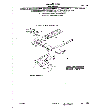

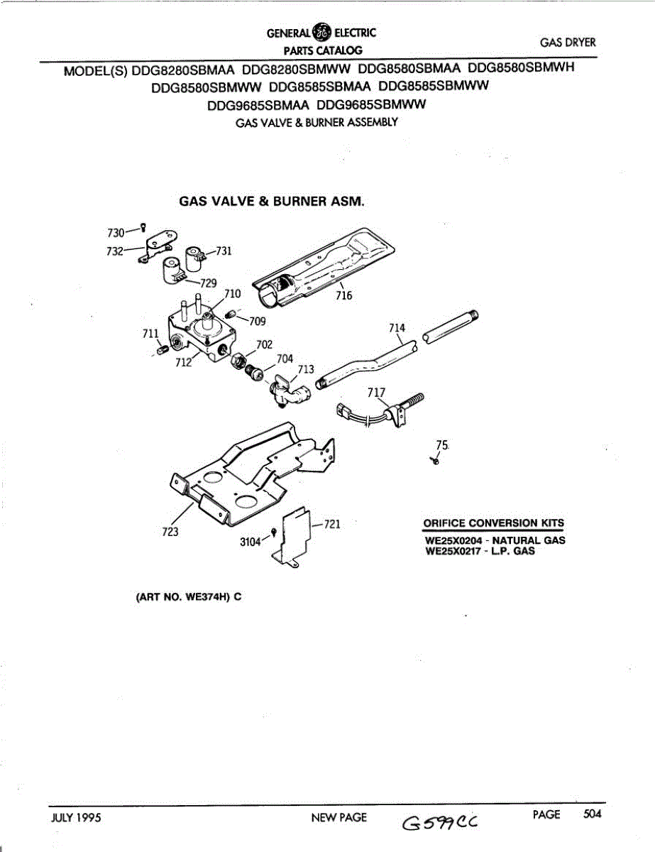

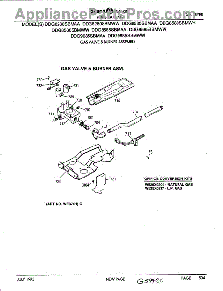

This orifice meters gas flow to a single burner, restoring proper flame size and stable heating for gas ranges and ovens. Replacing a damaged or clogged orifice helps improve ignition and consistent burner performance. What it does:
  • Controls the amount of gas delivered to the burner for correct flame height and heat output
  • Helps resolve weak or low flames and uneven heating when the orifice is clogged or worn
  • Supports reliable ignition by maintaining proper gas flow to the burner
  • Works as the precise gas port that matches the cooktop/oven's burner assembly
What's included: One orifice Install notes:
  • Turn off the appliance and shut off the gas supply before servicing
  • Use appropriate tools to remove burner components; take care not to damage threads or fittings
  • After installation, check all connections for leaks with a soap solution or approved leak detector

This gas valve regulates and safely delivers fuel to your dryer's burner. When operating correctly, it opens for ignition and closes when heat is satisfied, providing consistent, reliable heating for effective drying.
  • Opens to allow gas into the burner when the ignition system calls for heat
  • Closes to stop gas flow during cycling or if ignition fails
  • Possible symptoms: dryer runs but no heat; igniter glows yet no flame; intermittent heat or long dry times
  • Helps restore proper burner ignition and stable flame
What's included: 1 gas valve Install notes:
  • Disconnect power and shut off the gas supply before servicing
  • Work in a well-ventilated area; check all connections for leaks with a non-corrosive leak-detection solution after installation
  • Transfer any brackets, fittings, or orifices from the original valve as required; secure connections
  • Confirm gas type (natural/LP) and regulator/orifice settings per the service manual before restoring service

This burner assembly is the combustion head for GE gas dryers. It mixes gas and air and directs a stable flame into the heater housing, restoring consistent heat when the original burner is corroded, warped, or clogged.
  • Directs the gas flame into the heat chamber for proper drying temperatures
  • Works with the igniter, flame sensor, and gas valve to produce heat
  • Typical failure symptoms: no heat or intermittent heat, long dry times, burner lights then goes out, unstable/yellow flame
  • Physical issues can include rust, warping, or blocked burner ports
What's included: 1 burner assembly Installation notes:
  • Disconnect power and shut off the gas supply; allow the dryer to cool completely
  • Note position of the igniter and flame sensor relative to the burner port; realign during reassembly
  • Transfer any reusable fittings from the original burner as needed and verify orifice/fuel type match your installation
  • After reconnecting gas, perform a leak check with a non-corrosive soapy water solution before restoring power
