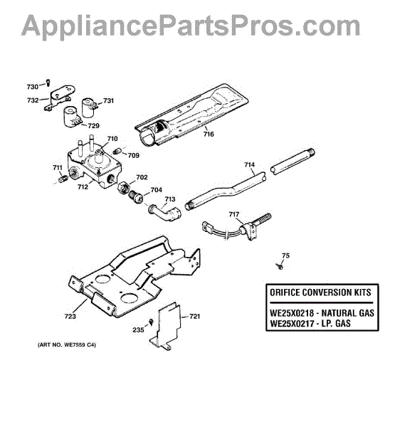

Parts for Ge DLSR483GE0WW: 05 - Gas Valve & Burner Assembly Parts
75
This replacement part is a screw, and it is intended for use in different types of appliances. This is a genuine replacement part made by General Electric. This screw is compatible with many different areas of the appliance. Screws are generally used for keeping parts of the machinery secure and in place during use. It is possible that screws can become loose over time and need to be replaced after years of normal wear and tear.A new screw might be needed if the user notices parts of the appliances are becoming loose or are even falling off. This can be due to screws becoming stripped over time or if the appliance is bumped during transport. The repair for this part is simple. Remove the old screw and replace it with a new part. The only tools needed for this repair are a screwdriver and possibly pliers if the damaged screw is stuck in place.This screw is sold individually and is a genuine OEM replacement part sourced from the manufacturer.
$9.20
$10.07
$0.87
235
A replacement screw used to secure panels and components in compatible GE appliances. Replacing missing or damaged screws restores secure mounting, reduces rattling, and helps keep parts aligned during normal operation. What it does:
  • Fastens panels, trim, brackets, or small appliance components to maintain proper alignment and fit.
  • Keeps internal parts secured to reduce vibration, rattling, or movement during use.
  • Replaces stripped, rusted, or missing hardware that can cause loose or misaligned panels.
  • Small, non-electrical part — does not affect electrical circuits or controls.
  • Disconnect power and unplug the appliance before accessing internal parts.
  • Use the properly sized screwdriver to avoid stripping the head; hand-start threads to prevent cross-threading.
  • Tighten securely but avoid over-torquing; overtightening can strip threads or damage plastic components.
  • Keep track of small parts and hardware; replace any damaged or mismatched screws with the correct OEM part.
$8.39
$9.98
$1.59
702
704
709
This orifice meters gas flow to a single burner, restoring proper flame size and stable heating for gas ranges and ovens. Replacing a damaged or clogged orifice helps improve ignition and consistent burner performance. What it does:
  • Controls the amount of gas delivered to the burner for correct flame height and heat output
  • Helps resolve weak or low flames and uneven heating when the orifice is clogged or worn
  • Supports reliable ignition by maintaining proper gas flow to the burner
  • Works as the precise gas port that matches the cooktop/oven's burner assembly
What's included: One orifice Install notes:
  • Turn off the appliance and shut off the gas supply before servicing
  • Use appropriate tools to remove burner components; take care not to damage threads or fittings
  • After installation, check all connections for leaks with a soap solution or approved leak detector
$35.95
$42.78
$6.83
710
$9.43
$11.13
$1.70
711
712
This gas valve regulates and safely delivers fuel to your dryer's burner. When operating correctly, it opens for ignition and closes when heat is satisfied, providing consistent, reliable heating for effective drying.
  • Opens to allow gas into the burner when the ignition system calls for heat
  • Closes to stop gas flow during cycling or if ignition fails
  • Possible symptoms: dryer runs but no heat; igniter glows yet no flame; intermittent heat or long dry times
  • Helps restore proper burner ignition and stable flame
What's included: 1 gas valve Install notes:
  • Disconnect power and shut off the gas supply before servicing
  • Work in a well-ventilated area; check all connections for leaks with a non-corrosive leak-detection solution after installation
  • Transfer any brackets, fittings, or orifices from the original valve as required; secure connections
  • Confirm gas type (natural/LP) and regulator/orifice settings per the service manual before restoring service
$115.37
$137.29
$21.92
713
This valve elbow redirects the appliance's water line to the inlet valve, providing a secure 90° connection to help prevent kinks and ensure consistent water flow. Simple, compact replacement for a worn or damaged elbow. What it does
  • Redirects the water supply line to the appliance inlet valve for a neat, low-profile connection
  • Helps prevent kinking or strain at the inlet connection that can lead to leaks
  • Restores proper water routing when the original elbow is cracked, broken, or leaking
  • Resolves symptoms such as visible leaks at the valve connection or reduced/disrupted water flow to dispensers or ice makers
What's included One valve elbow Install notes
  • Turn off water supply and unplug the appliance before beginning work
  • Drain residual water from the line before removing the old elbow to minimize spills
  • Inspect the inlet fittings and water line for damage; replace any worn tubing or gaskets
  • Use appropriate tools and replacement gaskets; hand-tighten fittings and check for leaks after restoring water
$50.69
$56.32
$5.63
714
$35.95
$61.53
$25.58
716
This burner assembly is the combustion head for GE gas dryers. It mixes gas and air and directs a stable flame into the heater housing, restoring consistent heat when the original burner is corroded, warped, or clogged.
  • Directs the gas flame into the heat chamber for proper drying temperatures
  • Works with the igniter, flame sensor, and gas valve to produce heat
  • Typical failure symptoms: no heat or intermittent heat, long dry times, burner lights then goes out, unstable/yellow flame
  • Physical issues can include rust, warping, or blocked burner ports
What's included: 1 burner assembly Installation notes:
  • Disconnect power and shut off the gas supply; allow the dryer to cool completely
  • Note position of the igniter and flame sensor relative to the burner port; realign during reassembly
  • Transfer any reusable fittings from the original burner as needed and verify orifice/fuel type match your installation
  • After reconnecting gas, perform a leak check with a non-corrosive soapy water solution before restoring power
$58.21
$69.27
$11.06
717
4.9 (43)
The Igniter is an OEM part for GE dryers. It is designed to ignite the gas burner to produce heat, which is essential for drying clothes. The igniter ensures that the gas is lit efficiently and safely, enabling the dryer to reach and maintain the proper temperature for effective drying.
You should replace the igniter if it becomes faulty. Causes of a bad igniter can include electrical failures, cracks or breaks in the igniter material, or wear and tear from regular use. These issues can prevent the igniter from generating the necessary heat to ignite the gas.
Symptoms of a bad igniter include:
  • The dryer not heating up
  • Extended drying times
  • The igniter glowing but failing to light the gas burner
  •  A lack of flame in gas dryers
$55.24
$65.74
$10.50
721
723
$13.68
$19.38
$5.70
729
4.8 (36)
The Dual Coil is an OEM part for GE dryers. This is often referred to as the “M” coil. If you need to replace both the main coil and dual coil, it is recommended to order the kit 279834, which includes both coils for a comprehensive replacement.
Causes of a faulty dual coil can include wear and tear over time, electrical component failure, or damage due to overheating or excessive usage. These factors can result in insufficient heat production, inconsistent drying, or no heat at all.
Symptoms of a bad dual coil may include:
  • Insufficient heat or no heat during the drying cycle
  • Inconsistent drying results
$33.95
$40.06
$6.11
730
Specs: 8-32 ca hxw 1/2
$7.37
731
4.8 (33)
The Main Coil is an OEM part for GE dryers. It is a crucial component of the gas valve assembly, responsible for opening the gas valve to allow gas flow to the burner, enabling the dryer to produce heat.
Causes of a bad main coil can include electrical faults such as short circuits or open circuits within the coil, wear and tear from prolonged use, or damage due to overheating. Over time, the coil's ability to control the gas flow can diminish, affecting the dryer's performance.
Symptoms of a bad main coil include:
  • Intermittent heating during a drying cycle
  • The dryer taking longer than usual to dry clothes
  • A clicking sound without the ignition of the burner
$26.32
$33.09
$6.77
732
