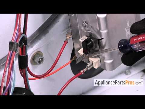

Cause #1 Dryer Heating Element
35%of the time
Total Satisfaction Rating (1639)
Cause #2 Dryer Thermal Fuse
28%of the time
Total Satisfaction Rating (2224)
