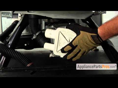

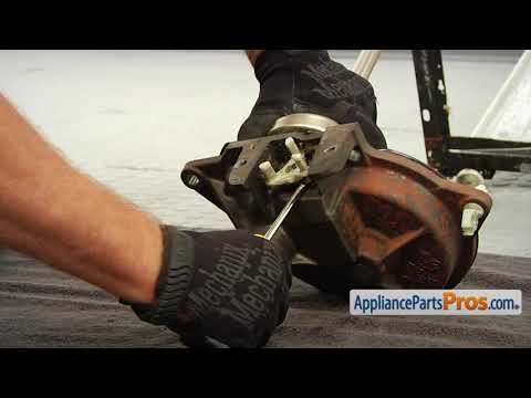

Cause #1 Whirlpool Direct Drive Washer Pump
69%of the time
Total Satisfaction Rating (632)

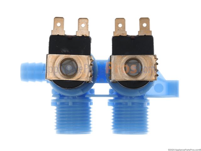

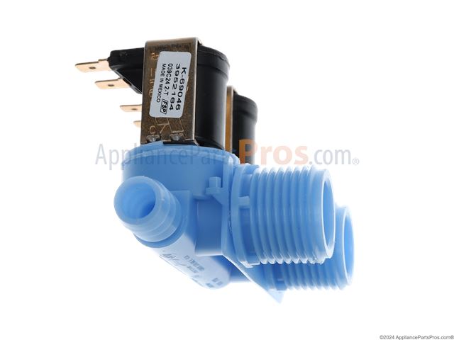

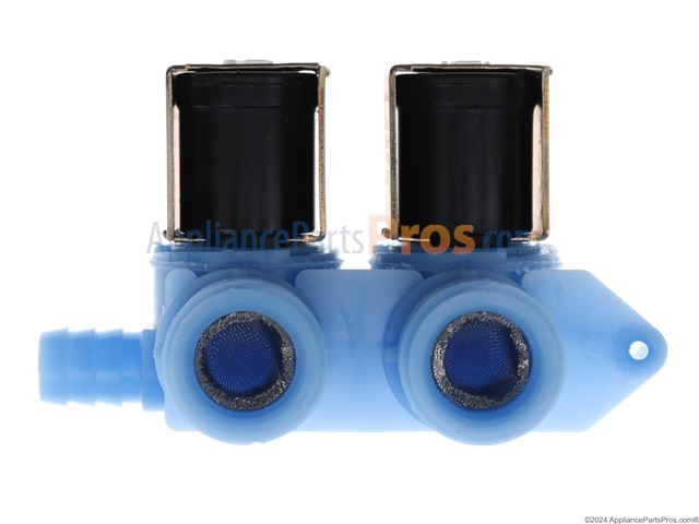

Cause #2 Water Inlet Valve
6%of the time
Total Satisfaction Rating (578)
