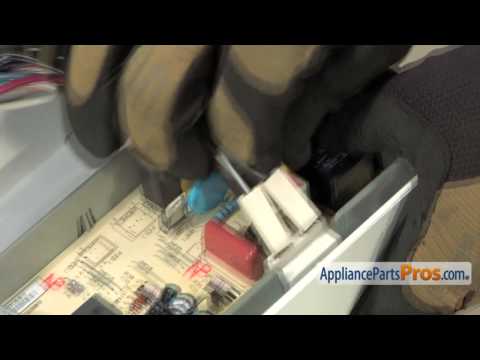

Cause #1 Dishwasher Fuse Kit
64%of the time
Total Satisfaction Rating (106)
