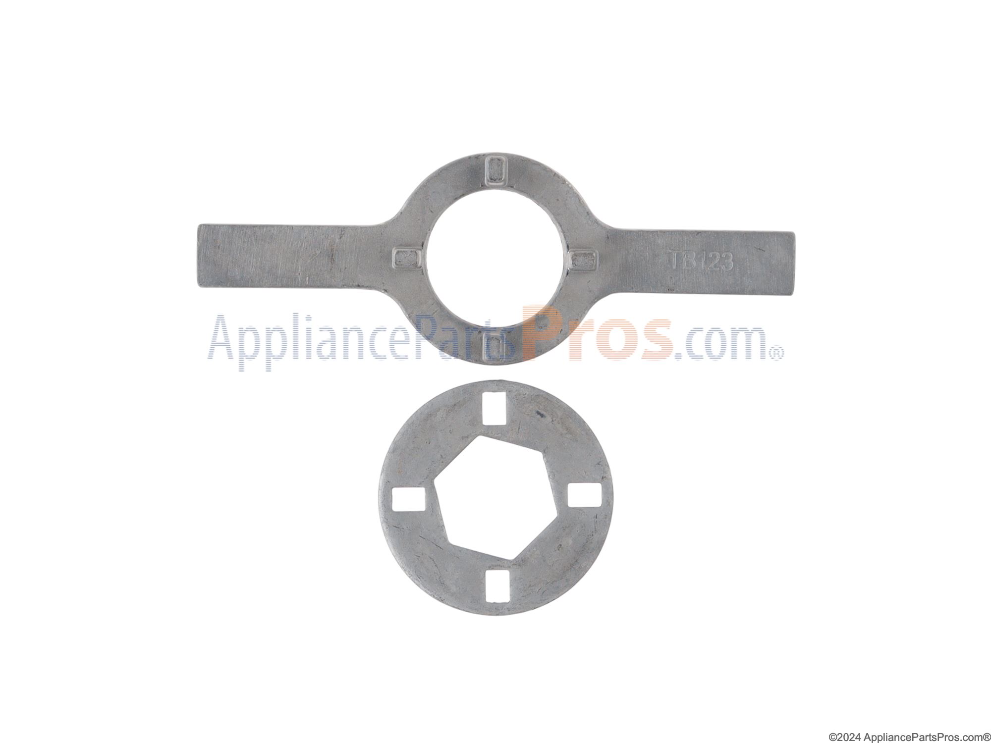

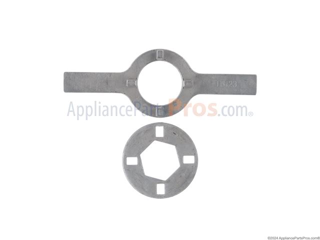

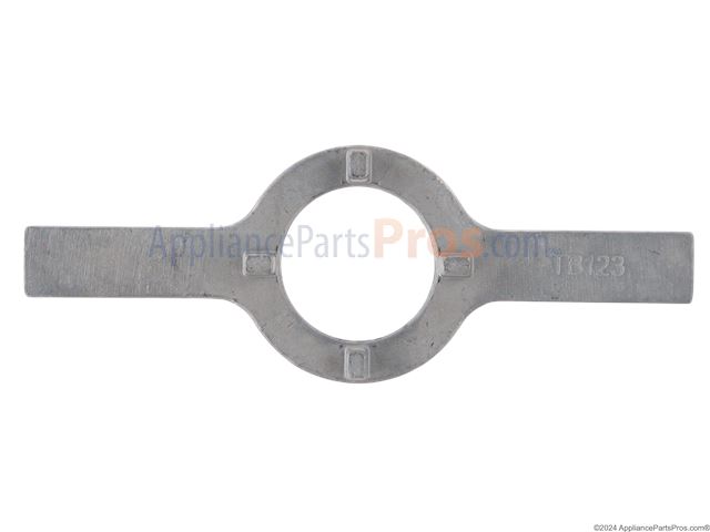

Gerald P Auburn , GA January 28, 2018 Appliance: General Electric Washer WHRE5550K2WW Ge washer making loud roaring noise during spin cyc;e I had never worked on a washing machine before but after watching the online videos I felt like I could do the repair. I was almost positive it was the Mode Shifter and Shaft Assembly that was bad. I could hear the bearing making a grinding noise when I turned the tub by hand. I ordered the part I needed plus additional parts that could be an issue later such as a drive belt, tub bearing, tub seal, tub nut, split ring, etc; Preventive maintenance that would keep from having to tear it all apart again if another part failed. Took photos with my phone and kept the repair video handy while I took everything apart. The only difficulties I had were getting the tub nut off and tub bearing out. After spraying the tub nut with WD40 and letting it soak for approx.. 30 minutes I finally got it broken loose. I used a tub spanner wrench that I ordered with the parts. I would not have been able to get it off without it. Videos showed prying the tub bearing out with two screwdrivers which as hard as I tried I could not do. I turned the tub over and used a socket the same diameter as the tub bearing and had to knock it out with a hammer which worked. I replaced all the parts which went smoothly and put it all back together with the use of the video and photos I took. The final result was the washer worked like a charm and the roaring noise during the spin cycle was now gone. It was a somewhat time consuming project but the outcome made it worthwhile. I would like to say that ordering the parts from AppliancePartsPros was very easy. Just search by model number for parts. I ordered the parts on Tuesday morning and they shipped the same day and arrived Thursday at lunch time. Very quick service. Repair up and running by Friday afternoon. Read More... 266 People found this story helpful Do-It-Yourself Rating: Repair Time Estimate: 2+ hours Tools: Nut Drivers, Pliers, Screwdrivers, Socket Set
Gabriel S Petaluma , CA March 15, 2015 Appliance: Maytag Top Loading Washer A112 Leakage from tub seal I ordered the tub seal and stem seal kits along with the much needed spanner wrench. After viewing the video online several times and taking notes along the way I was ready to tackle the repair. After taking everything apart, I cleaned all areas thoroughly then addressed the rusty areas and mineral deposits found in the tub. Soaking the tub in vinegar and baking soda overnight helped loosen the built up deposits enough so I could carefully scrape them off with a spatula. This was very time consuming. Next was to clean off the rust with a wire brush and 3M Scotch pad. Using Eastwood's Rust Encapsulator, I sprayed the treated areas, it acts as a rust inhibitor and top coat in one. Assembling the seals and associated parts was pretty straight forward but I had difficulty positioning the tubs top piece accurately since it was an older design utilizing the rubber seal with a metal band around it. Positioned too high, the top touches the lid, too low, it makes contact with the rotating inner tub. When doing the dry spin for 3 minutes to set the seals. There was a loud banging from the inner tub hitting the outer one. I took everything apart and found the outer tub to be out of round. After pressing and bending on all sides I finally got it as round as I could and reassembled everything. Now was the moment of truth. Now the washer functions as it should, no water leakage or banging noise. For me it was an ordeal as I never attempted this job before (and may never again). Just a word of caution handling the outer tub, be very careful not to bend it out of round otherwise you'll have a lot of anxiety with this job. Now it's martini time! Read More... 239 People found this story helpful Do-It-Yourself Rating: Repair Time Estimate: 2+ hours Tools: Pliers, Screwdrivers, Socket Set, Wrench Set
