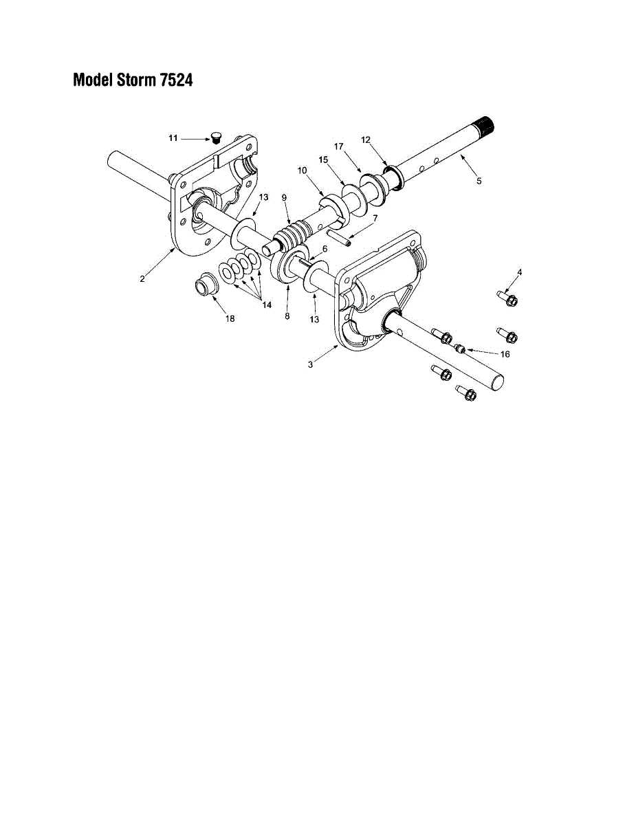

This self-tapping screw is used to attach various parts to the engine housing of medium sized gasoline powered engines, in particular yard tools such as tillers, snow blowers, yard tractors, riding mowers, power vacuums, shredders, and chippers. It is used in over 150 different gasoline powered engines. Screws such as these are used particularly when a device is going to receive a great amount of vibration and stress while the engine is running and rotating tools are engaged. Such devices sustain a great deal of wear over time and the parts subject to replacement will eventually fail and need to be replaced. In such cases, it is wisest to replace the attaching hardware such as housing screws as well, because it is a self-tapping screw. Screws of this type are designed to forge a tight bond between the metal pieces they are securing together, but once loosened, they should ideally be replaced with new hardware. Make sure when replacing these screws to use genuine OEM parts like these screws. These replacement parts are manufactured to be identical to the original pieces. This hex screw is compatible with the following brands: MasterCut, Yard-Man, Yard Machine, Montgomery Wards, MTC, Murray, Bolens, Craftsman, Turf King, Troy Bilt, Cub Cadet, Huskee, Toro, and Ryobi.

This replacement part is an impeller shaft. It is a genuine replacement part made by MTD. Impeller shafts are able to rotate at high speeds and assist the engine in operating smoothly and effectively during use. If this part is not working properly it is possible that the engine might not work either.A new impeller shaft might be needed if the current one is damaged or missing. If the engine is not working properly, it can be because of the impeller shaft. Be sure to wear working gloves while replacing this part as the impeller can be sharp and dangerous if handled. Refer to the specific user manual for more information on how to replace this part. This part is a genuine OEM replacement part to ensure long-lasting use and proper fit. This impeller shaft is sold individually and is sourced directly from the manufacturer.

In a snowblower, the driveshaft is connected to a part called a worm gear. The worm gear turns the auger blades which eject the snow. The worm gear is connected to the worm shaft, which causes the auger blade to turn rapidly. Eventually, the incredible torque inside the machine, plus the occasional bumps and bruises experienced by the machine in operation and when being stowed, may cause the worm gear to malfunction. When the snowblower is erratic in its operation and fails to remove snow completely, there is a good chance the problem is the worm gear. To replace the worm gear, remove the housing to get to the worm shaft. Remove the entire worm assembly. Next, remove the blower fan and remove the worm gear. Grease the auger assembly before installing the new gear. Reverse the order to reassemble. While the snowblower is disassembled, it's the best time so exam the auger, driveshaft, sheer bolts, and tires for wear. You may find other parts that need to be updated. Make sure to replace the worm bolt and any other necessary parts with a genuine OEM manufactured part such as this one. This gear can be used in a number of snowblowers, including machines made by Yard Machines, Craftsman, Bolens, Yard-Man, Troy-Bilt, Cub Cadet, Ryobi, Montgomery Wards, Huskee, and MTD. Part sold individually.

This thrust collar is a genuine MTD part, sold individually. A thrust collar can be used as a replacement part in a snowblower. This genuine OEM part is made out of high quality, durable metal material meant to stand up to exposure to the elements and to general wear and tear over long-term usage.The thrust collar in a snowblower may be subject to various forms of damage at any point during the typical lifespan of the appliance. If damaged, the thrust collar should be removed and replaced by this genuine OEM replacement part in order to guarantee safe continued use. Remember to always wear gloves when handling, repairing, and operating outdoor equipment. Always unplug the appliance before performing any kind of repair or replacement.Sourced directly from the manufacturer, this component is a genuine replacement part that is sold individually. This thrust collar is compatible with the following outdoor appliance brands: MTD, Craftsman, Cub Cadet, Ryobi, Troy-Bilt, Yard Machines, Huskee, Montgomery Wards, Bolens, and Yard Man.

This grease plug is a genuine OEM replacement part sourced directly from the manufacturer. It is found on snowblowers and other outdoor yard machines on the gearcase assembly, which houses the auger gear. The grease plug seals the oil port on the gearbox. This keeps lubrication inside the gearbox and is the access point for adding more when needed. If this plug is lost, the gearbox's oil could leak out, and contaminants could get into the gearbox.Lubricate the contents of the gearbox before installing the new grease plug. Locate and remove the two screws on the side to drain the gearbox. Install the grease plug in the bottom. Refill the oil using the vent hole. Continue filling until oil is coming out the top side screw. Close everything back up, and the machine is ready for use. To prepare the equipment for long storage, remove the grease plug and check the oil level. If it is not to the top, add more lubricant before sealing the grease plug.This grease plug is made of durable black molded plastic and is sold as an individual unit. It is compatible with snowblowers and snow throwers manufactured by Ryobi, MTD, Yard Machines, Troy-Bilt, Bolens, Yard-Man, Cub Cadet, and Husky.

This is a genuine OEM oil seal sourced directly from the manufacturer for use in the engines of snowblowers and snowthrowers. Oil leaks are prevented using this oil seal on the worm shaft and beside the bearing-flange. It is made from durable plastic that is designed for heavy use; however, over time, the seal can become worn or damaged. Damage or wear to the oil seal can result in oil leaks and loss of engine performance. The oil seal will need to be replaced if oil is leaking from the snowblower. Replacing the oil seal will require a wrench set, pliers, and socket set. Following the diagram for the correct equipment model, disassemble the engine to reach the worm shaft and remove the damaged oil seal. Clean any old lubricant on the area. Install the new oil seal with fresh lubricant. Replace the engine parts in reverse order. Regular lubrication of the worm shaft will add to the engine's performance and prolong the life of the oil seal.This oil seal is sold individually. It is made for snowblowers and snow throwers manufactures by Ryobi, MTD, Yard Machines, Bolens, Yard-Man, Troy-Bilt, Cub Cadet, and Husky.
