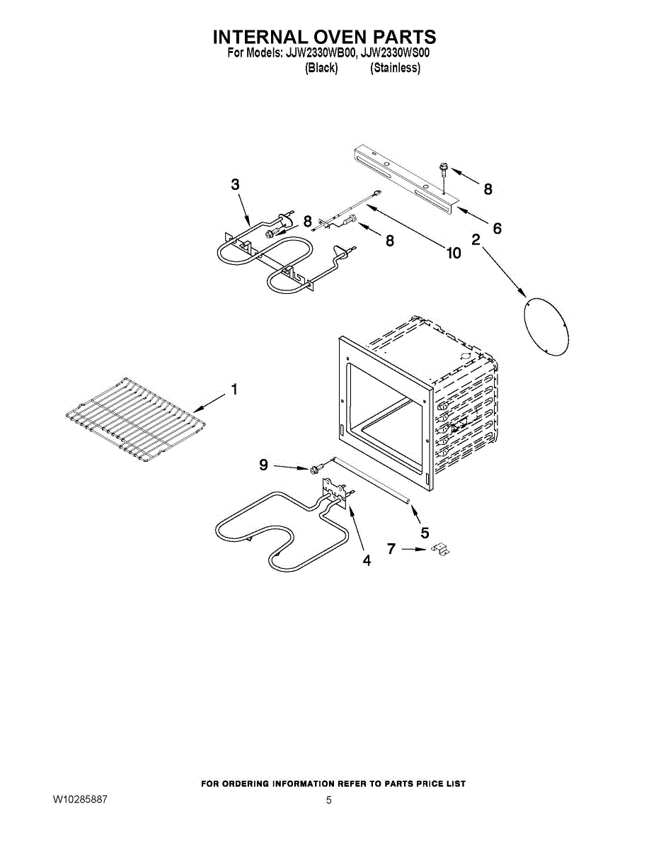

This 30" baking rack is a replacement oven shelf that supports pans and bakeware for even cooking and simple removal. It restores proper airflow and usable oven space so trays and dishes sit level during baking. What it does:
  • Provides a stable support for sheet pans, casserole dishes and racks while baking or roasting
  • Promotes even heat circulation by allowing air to flow around cookware
  • Replaces bent, warped or missing oven shelves that cause uneven cooking or unstable cookware
  • Fits standard 30" oven cavities designed for a full-width baking shelf
What's included: One 30" baking rack (single shelf) Install notes:
  • Turn oven off and allow it to cool completely before installing
  • Slide rack into upper or lower shelf guides until it seats firmly; do not force
  • Avoid using abrasive cleaners or excessive heat (self-clean cycle may discolor or damage finish)
  • If rack is coated, inspect for chips or deep corrosion before use; replace if coating is compromised

Restore proper top heat to your oven with this broil element. It delivers the intense, even radiant heat needed for broiling, so foods brown and sear correctly when the original element fails or is damaged.
  • Supplies high, direct heat from the top of the oven during Broil
  • Common fix for no-broil or weak broiling performance
  • Replace if the element is blistered, cracked, warped, or shows arcing
  • Help resolve uneven browning or a tripped breaker caused by a shorted element
What's included: 1 broil element
  • Remove oven racks; unfasten the element's mounting screws and gently pull it forward
  • Support and disconnect the wires; attach them to the new element and position it
  • Secure the element, ensure connections are tight and clear of metal, then restore power and test

The bake element is the lower heating element inside an electric oven cavity. Replacing a failed element restores consistent baking performance, proper preheat times, and reliable temperature control.
  • Provides the primary bottom-oven heat source used in Bake mode
  • Common failure symptoms: no heat during bake or very slow preheating
  • Oven may not reach set temperature or cook evenly
  • Visible damage may include blistering, cracks, or breaks in the element sheath
What's included: 1 bake element Install notes:
  • Disconnect power at the breaker before servicing and allow the oven to cool completely
  • Remove oven racks for access; take a photo of wiring to aid reassembly
  • Remove mounting screws, gently pull the element forward, and transfer wires one at a time to the new element
  • Ensure the element sits level and clear of cavity walls; do not overtighten screws; restore power and test Bake
