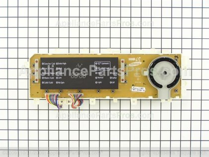

Yu-Mo for Model Number WF328AAR/XAA
Hello, I have two questions: Lightning strike near my house last night. Lots of things fried, the washer was one of them. I checked the board and power does get to it, but the power button is not turning on the washer. Nothing works, no displays. Am I ok to assume a new board will solve the issue? I'm seeing two references to the board. MFS-WF318A-T0 and MFS-WF318A-S0. So seems to be much cheaper for some reason. And the strange part is that the pictures I see for MFS-WF318A-T0 it does show a sticker with MFS-WF318A-S0 in front and WF318AT0 in the back. So whats going on? thank you.
1 Answer
Hello Yu-Mo. You will need to order MFS-WF318A-T0 for the model number you provided according to the manufacturer. They do not list the difference but it may be programming.
Read More...
Donald for Model Number WF328AAW/XAA
I replaced the control board but when I attempt to run the quick tests it doesn’t progress passed the software version, which is F23A. I’m able to run through the quick test mode with the existing board which is version F236, model F23. The drain test doesn’t work but no errors are displayed, it just doesn’t start the drain motor. There are other issues we’ve seen which seem to indicate the control board which is why I ordered the replacement. The washer still doesn’t work with the replacement board which is why I tried to go through the quick test. I did clear the eprom successfully (Delay Start, Signal and Power). Thoughts on the replacement board results, not getting passed the software version when entering the quick test mode? This is pressing the Spin Key, Silver Key and Power at the same time. Thanks.
1 Answer
Donald, With not being able to get past the programming mode, it sounds like the issue would be that you may have received a defective control board.
Read More...
