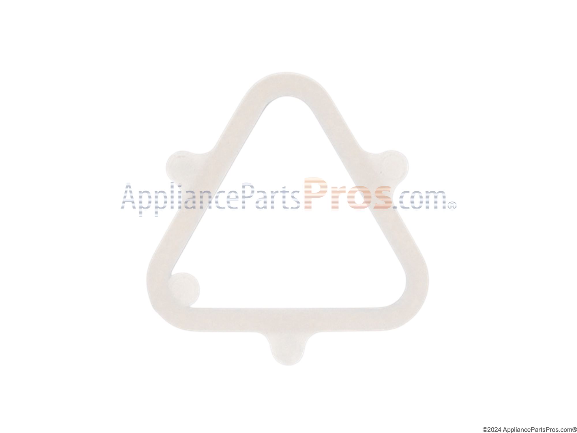

Cause #9 Drum Support Wheel Retainer
Less than 1%of the time
Total Satisfaction Rating (99)
