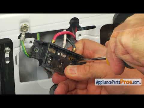

Won't start is the most common symptom for Estate TEDS840JQ2. The instructions below from DIYers like you make the repair simple and easy. Many parts also have a video showing step-by-step how to fix the "Won't start" problem for Estate TEDS840JQ2. So, if your TEDS840JQ2 dryer does not start when the door is closed, not starting or won't turn on, the following info will help you identify the problem.

Cause #3 Dryer Drive Motor
7%of the time
Total Satisfaction Rating (239)
