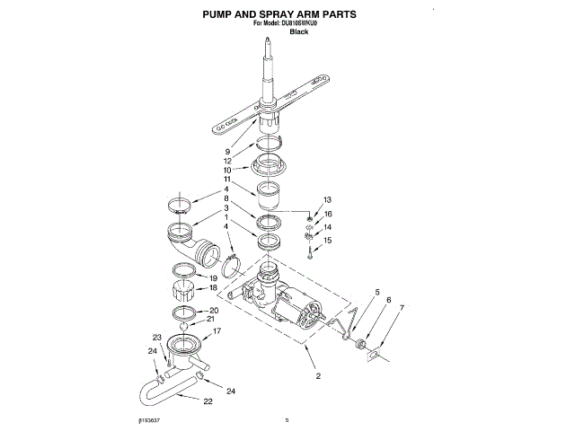

Cause #1 Lower Spray Arm
27%of the time
Total Satisfaction Rating (5)

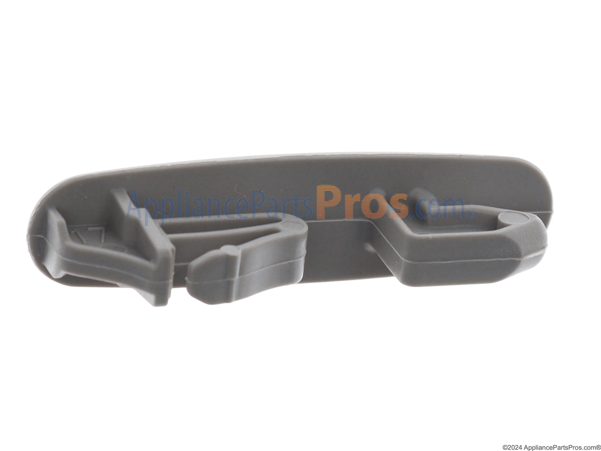

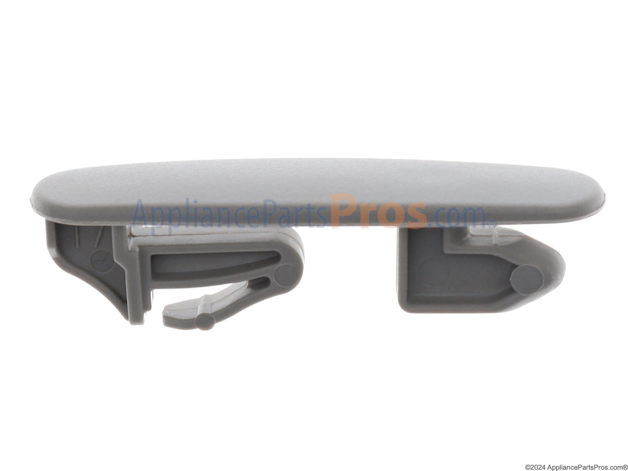

Cause #9 Dishwasher Rack Stop Clip
Less than 1%of the time
Total Satisfaction Rating (274)
