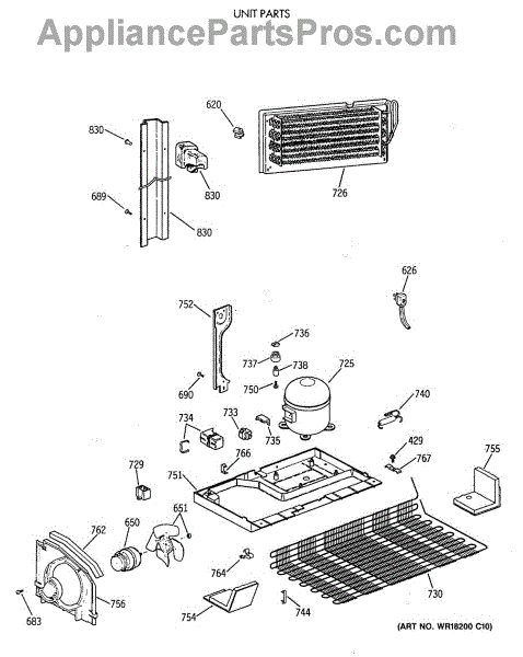

The Defrost Thermostat is an OEM part for GE refrigerators. This component plays a crucial role in the defrost system by regulating the temperature within the freezer. It ensures the defrost heater activates when the temperature rises above a certain threshold, preventing ice build-up on the evaporator coils and maintaining efficient cooling.
Over time, the defrost thermostat can fail due to electrical issues, prolonged exposure to extreme temperatures, or wear and tear from regular use. When this part fails, it can lead to improper defrost cycles, causing ice accumulation and reducing the refrigerator's efficiency.
Symptoms of a bad defrost thermostat include:
  • Excessive frost buildup in the freezer
  • Inconsistent temperatures in the refrigerator and freezer compartments
  • Refrigerator running continuously or not running at all
  • Leaking water inside the fridge due to melted ice

The Condenser Fan Motor is an OEM part for GE refrigerators. It is designed to circulate air through the condenser coils, helping to dissipate heat and keep the refrigerator's internal components cool. This ensures efficient operation and prevents the compressor from overheating, which is essential for maintaining the refrigerator's performance and longevity.
You should replace the condenser fan motor if it becomes faulty. Causes of a bad fan motor can include electrical failures, wear and tear from regular use, or blockages that cause the motor to overheat or burn out. A malfunctioning fan motor can lead to inadequate cooling, increased energy consumption, and potential damage to other refrigerator components.
Symptoms of a bad condenser fan motor include:
  • The refrigerator not cooling properly
  • Unusual noises coming from the back of the refrigerator
  • The compressor running hot or cycling on and off frequently
  • The condenser coils feeling excessively hot

The Run Capacitor is an OEM part for GE refrigerators. It plays a crucial role in the refrigerator's cooling system by providing the necessary start and run voltage to the compressor. Without a properly functioning run capacitor, your refrigerator may struggle to maintain the desired temperature, leading to spoiled food and inefficient energy use.
Causes of a bad run capacitor include electrical surges, wear and tear over time, or overheating due to a malfunctioning refrigerator compressor or poor ventilation.
  • The refrigerator compressor fails to start.
  • Unusual humming noises coming from the refrigerator.
  • The refrigerator cycles on and off more frequently than normal.
  • A noticeable increase in energy consumption as the refrigerator struggles to maintain the proper temperature.

This PTC start relay mounts on the refrigerator compressor and briefly energizes the start winding, then automatically opens as it warms. Replacing a weak relay helps restore reliable compressor starts and consistent cooling. What it does:
  • Provides momentary power to the compressor's start winding at startup; the PTC element opens as it heats
  • Helps ensure smooth compressor starts and reduces repeated start attempts
  • Signs of a failed start device can include no cooling because the compressor won't run
  • Clicking or buzzing from the compressor area every few minutes
  • Compressor starts intermittently or stops shortly after starting
  • Includes: 1 PTC start relay
  • Disconnect power and pull the refrigerator forward to access the rear service area
  • Remove the rear panel to reach the compressor compartment
  • Unplug the wire harness and pull the old relay straight off the compressor terminals; note its orientation
  • Push the new relay fully onto the compressor prongs, reconnect the harness, reinstall the panel, and restore power

This OEM Replacement Part is a compressor overload that attaches to the GE refrigerator compressors. It acts as a safety switch, shutting off the compressor motor if overheating or excessive current draw is detected. This protects the compressor from damage. Over time, the original overload may malfunction, causing insufficient cooling inside the fridge. Replacing a faulty overload restores proper temperature regulation and food safety. This manufacturer-supplied part meets original specifications and may rattle slightly when shaken, which is normal.
