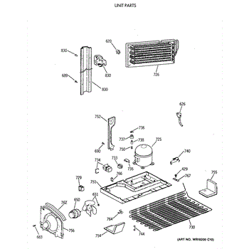

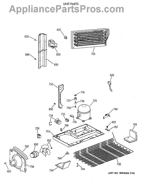

Parts for Ge CTX18CIXERWH: 06 - Unit Parts
