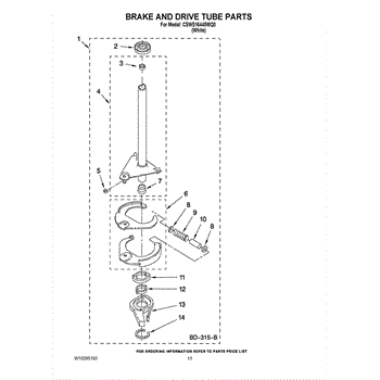

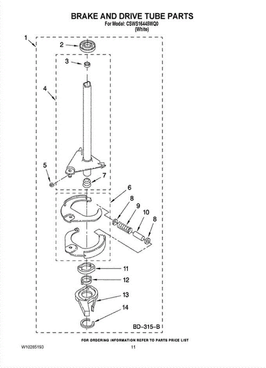

Parts for Whirlpool CSWS16445WQ0: 07 - Brake And Drive Tube Parts
