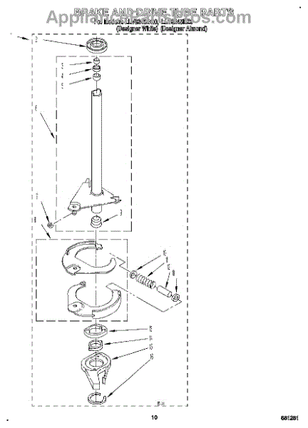

Parts for Whirlpool LLV8245DQ0: 08 - Brake And Drive Tube Parts
