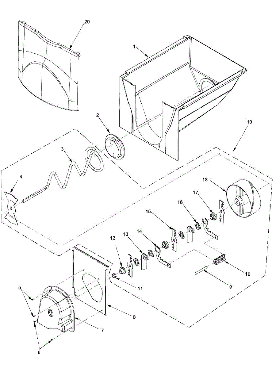

The Ice Crusher Bucket is an OEM part for Whirlpool refrigerators. It serves as a container for holding and crushing ice from the icemaker. The bucket houses the crushing mechanism that breaks down ice cubes into smaller pieces, making it convenient for dispensing crushed ice through the refrigerator's door.
Over time, the ice crusher bucket can become worn out or damaged due to regular use, exposure to moisture, or accidental impact.
Symptoms of a bad ice crusher bucket include:
  • The bucket not holding ice properly
  • Issues with dispensing crushed ice
  • Unusual noises during ice crushing
  • Visible cracks or damage to the bucket
$113.95
$135.60
$21.65
5.0 (28)
This end cap fits on the front of the ice-bin auger. It secures the auger shaft and blade stack inside the ice container so cubes or crushed ice dispense smoothly and the auger stays properly aligned.
  • Secures the front of the auger and blades in the ice bucket
  • Maintains auger alignment with the drive for reliable ice dispensing
  • Helps prevent jams and rattling in the ice container
  • Common symptoms of a failed cap: weak/no ice dispense, loose/wobbly auger, grinding or rattling noises, visible cracks or a missing cap
What's included: 1 end cap Install notes:
  • Disconnect power and remove the ice bin before servicing
  • Note the order of blades, spacers, and washers; take a photo for reassembly
  • Replace the cap and reassemble in the original order using existing hardware
  • Ensure the bin is fully seated and test dispense after restoring power

The ice auger and crusher blade crush and shave the ice that dispenses on a refrigerator. This part can be used to repair a refrigerator that is no longer dispensing ice. Sometimes when the ice dispenser malfunctions and makes a loud noise but doesn't dispense cubed or shaved ice, the problem is with the auger and crusher blade. Perform a visual inspection of the auger and crusher blade to ensure no external damage is done to the components.Disconnect the refrigerator from its power source before starting this repair. Open the freezer door to access the ice bucket and dispenser area. The bucket is held in place by fastening clips that can be pushed to remove the bucket. Lay the bucket flat on its back with the auger and blade facing upwards. Remove the old auger and crusher blade by removing the four hex screws. Remove the helix end-cap from the old auger system and replace it with the new one. Repeat these steps in reverse to install the new component.This Whirlpool ice auger and crusher is a genuine OEM product sourced directly from Whirlpool. The part listed is only available individually and is not included with any other parts or original appliances. This part is compatible with Whirlpool, Amana, Kenmore, and Maytag appliances.
