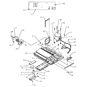

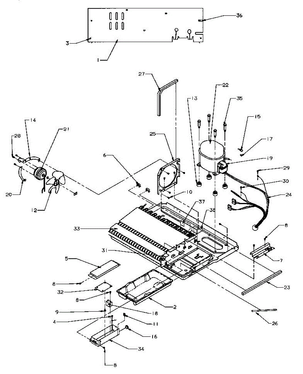

Parts for Amana SRD20S4W / P1190801W W: 13 - Machine Compartment Parts
