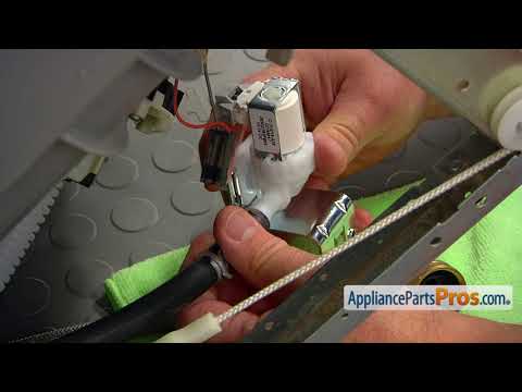

Randy R Hamilton , NJ June 23, 2019 Appliance: Model GDF520PSJ5SS GE APPLIANCE Valve water assembly Shut off the water going to the dishwasher, remove the toe kick, unscrew the dishwasher from the countertop, slide the dishwasher out about 12 inches, it is located on the left side, remove a wire clip , a rubber hose and the supply line,remove the two screws on the bottom, than reinstall the new part, reconnect everything, turn on the water, check for leaks, reinstall the toe kick to the dishwasher, job is done Read More... 6 People found this story helpful Do-It-Yourself Rating: Repair Time Estimate: Less than 15 minutes Tools: Nut Drivers, Pliers, Screwdrivers
