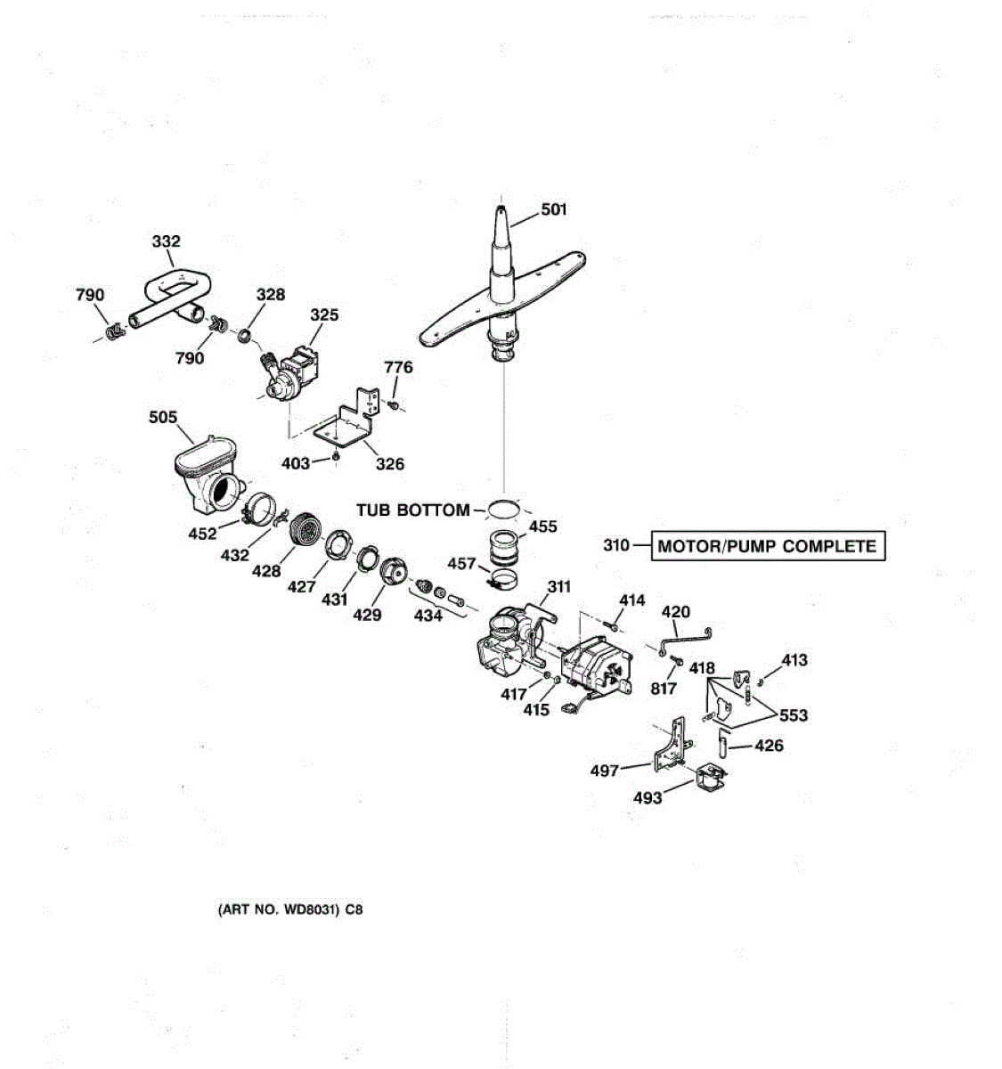

The Complete GE Pump and Motor Assembly is an OEM replacement part for GE dishwashers. This assembly is integral to the dishwasher’s functionality, as it combines both the pump and motor components that work together to circulate water during the wash and rinse cycles. The pump forces water through the spray arms, while the motor drives this process, ensuring thorough cleaning of the dishes.
Over time, the pump and motor assembly can wear out due to constant use and exposure to water and detergents. Additionally, debris or hard water buildup can clog the pump, causing strain on the motor and leading to failures. Electrical issues or damage from power surges can also impair the assembly's performance.
Symptoms of a bad pump and motor assembly include:
  • The dishwasher not cleaning dishes properly
  • Water not circulating or spraying during cycles
  • Unusual noises, such as grinding or humming, coming from the dishwasher
  • Water not draining properly from the tub
  • The dishwasher not starting or completing cycles

The Check Valve Flapper is an OEM replacement part for GE dishwashers. It is a small but crucial component located within the water inlet valve assembly. The check valve flapper regulates water flow into the dishwasher, allowing water to enter during the fill cycles but preventing backflow when the water is drained.
Causes of a bad check valve flapper can include wear and tear over time, mineral buildup that causes sticking, or damage to the flapper itself. This prevents the flapper from opening and closing as intended.
Symptoms of a bad check valve flapper include:
  • Slow or incomplete filling of water
  • Dripping or leaking water from the inlet area
  • Error codes related to water issues
This GE replacement part is also compatible with Hotpoint, RCA, and some Kenmore dishwasher models.

The Dishwasher Shaft Seal is an OEM part for GE dishwashers. This seal is located around the motor shaft and prevents water from leaking out of the dishwasher tub where the motor shaft enters.Seal for pump drain valve shaft. Instruction sheet included. Push-on nut may have to be cut off, order WR2X7054.
Over time, regular use can cause the seal to deteriorate, or debris and mineral deposits can lead to damage. A compromised shaft seal can result in water leaks, potentially causing damage to your kitchen floor and dishwasher components.
Symptoms of a bad dishwasher shaft seal include:
  • Water leaking from the bottom of the dishwasher
  • Puddles or water damage around the dishwasher area
  • Unusual noises coming from the motor area due to water infiltration
  • Visible wear or cracks on the seal

The Solenoid Armature and Linkage is an OEM replacement part for GE dishwashers. It is responsible for controlling the dishwasher's draining process by operating the drain valve, which regulates the flow of water out of the dishwasher during the drain cycle.
Symptoms of a bad solenoid armature and linkage include:
  • Dishwasher not filling with water or filling improperly
  • Water leaks from the inlet valve area
  • Dishwasher not advancing to the next cycle due to water flow issues
  • Error codes or indicators related to water inlet problems
Causes of a bad solenoid armature and linkage can include mineral buildup or debris obstructing the valve, electrical malfunctions in the solenoid coil, or mechanical wear and tear of the linkage components.

This kit is used to repair a leaking pump on GE made dishwashers. For a complete pump/motor assembly get WD26X10013.

This sump clamp secures the dishwasher sump to the tub assembly, keeping the gasket compressed for a watertight seal. Replacing a weakened or corroded clamp helps stop leaks from the base and restores proper wash system sealing.
  • Holds the sump firmly to maintain seal compression
  • Helps prevent water leaking from the bottom of the dishwasher during operation
  • Replace when the existing clamp is rusted, broken, stripped, or won't tighten
What's included: One sump clamp. Install notes:
  • Disconnect power at the breaker and shut off the water supply
  • Remove the toe kick and, if needed, pull the dishwasher forward for access
  • Position the clamp over the sump-to-tub joint and tighten evenly; do not overtighten
  • Reseat the sump gasket and run a leak test after reassembly

This OEM Replacement Part is a rubber connector with female threads. It is designed to provide a secure connection between the spray arm and the pump in a dishwasher. The connector measures 2-3/4 inches in diameter and 2-1/8 inches in height. This part is crucial to ensuring the proper functioning and efficiency of your dishwasher's spray arm pump.
Over time, the pump connector can wear out or become damaged due to repeated exposure to water, detergent, and high temperatures. This wear and tear can lead to leaks or a decrease in the dishwasher’s performance.
Symptoms of a bad pump connector include:
  • Water leaks under or around the dishwasher
  • Reduced water pressure during the cleaning cycle
  • The dishwasher not draining properly
Note: This connector has female threads. For male threads use WD18X206.

A replacement clamp that secures hoses or wiring to keep lines routed and stable, helping prevent rubbing, leaks and noise. Restores a reliable hold for tubing and harnesses so the appliance runs quietly and safely. What it does:
  • Holds hoses, tubing or wire harnesses in place to reduce movement and chafing.
  • Helps prevent leaks and water line abrasion caused by loose fittings.
  • Reduces rattling or vibration from unsecured lines or cables.
  • Keeps routing organized so adjacent components aren't stressed or worn.
What's included: One clamp. Install notes:
  • Disconnect power before servicing the appliance; shut off water supply when working on water or drain lines.
  • Remove the old clamp and position the replacement so it fully engages the hose or harness, avoiding twists.
  • Use appropriate hand tools (pliers or screwdriver) and secure the clamp evenly; avoid overtightening.
  • Inspect surrounding hoses and wiring for damage while installing; replace any components that show wear.

The Drain Solenoid is an OEM part for GE dishwashers. This component controls the draining function by opening and closing the drain valve, ensuring that water is properly expelled from the dishwasher at the appropriate times during the wash cycle.
Common causes of a bad drain solenoid include electrical malfunctions, buildup of debris or mineral deposits, and general wear over time. These issues can prevent the solenoid from operating correctly, leading to improper draining.
Symptoms of a bad drain solenoid include:
  • Standing water at the bottom of the dishwasher after the cycle
  • Unusual noises during the draining process
  • Error codes related to draining
  • Water leakage from the dishwasher

The spray arm assembly distributes pressurized wash water through its jets and rotates to clean dishes. If it's cracked, clogged, or not turning freely, replacing it restores proper spray coverage and cleaning performance.
  • Directs water through jet openings to wash dishes throughout the tub
  • Rotates by water force for even spray coverage
  • Common symptoms: poor cleaning results, arm not spinning, visible cracks/warping, or clogged holes
  • May cause unusual knocking if the arm is loose or contacting items
What's included: One spray arm assembly. Install notes:
  • Remove the lower rack; release the existing spray arm from the center retainer (method varies by model)
  • Clear any debris from the pump outlet and seating surface
  • Seat the new arm fully and ensure it spins freely before running a test cycle
