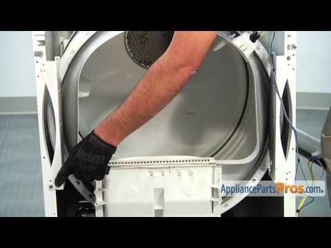

Takes too long to dry is the 2nd most common symptom for Norge DEP223M. It takes 15-30 minutes to fix on average. The instructions below from DIYers like you make the repair simple and easy. Many parts also have a video showing step-by-step how to fix the "Takes too long to dry" problem for Norge DEP223M. So, if your DEP223M dryer takes longer to dry than normal, taking forever to dry or taking too long to dry clothes, the following info will help you identify the problem.

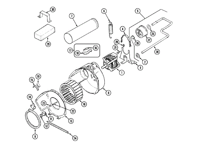

Cause #6 Blower Wheel
4%of the time
Total Satisfaction Rating (14)
