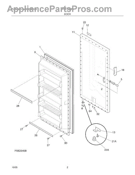

The Door Gasket is an OEM part for Frigidaire refrigerators. It ensures a tight seal around the door, preventing cold air from escaping and maintaining the set temperature inside the appliance. Over time, the gasket can wear out, become brittle, or lose its elasticity, leading to gaps between the gasket and the appliance frame. The gasket measures approximately 31" x 60"
Causes of a bad door gasket can vary from normal wear and tear to accidental damage.
Symptoms of a bad Gasket include:
  • Noticeable gaps or tears in the gasket
  • Difficulty in maintaining the set temperature
  • Condensation or frost buildup around the door

The Freezer Door Key is an OEM replacement part for Frigidaire refrigerators. This small but essential component is designed to securely lock the freezer door, preventing accidental openings or unauthorized access.
Symptoms of needing to replace the freezer door key include:
  • Difficulty in locking or unlocking the freezer door
  • The key not fitting properly or becoming stuck in the lock
  • Visible wear, damage, or breakage of the key itself
Causes of a faulty freezer door key can include normal wear and tear over time, physical damage due to impact or mishandling, or issues with the locking mechanism itself.

This bearing installs in the refrigerator/freezer door hinge to provide a smooth pivot point and maintain alignment. Replacing a worn bearing restores easy door movement and helps the door close and seal correctly.
  • Provides a low-friction surface between the hinge pin and hinge bracket for smooth door pivoting
  • Helps maintain proper door height and alignment for a reliable gasket seal
  • Typical symptoms of wear: squeaking or grinding when opening, door binding or dropping, door not closing fully or popping open
  • Excess wear can contribute to air leaks and frost buildup around the door
What's included: 1 bearing Install notes:
  • Disconnect power before servicing; remove or secure items in the door
  • Support the door; remove hinge fasteners and lift the door off if required
  • Note and retain any shims/spacers; install the new bearing in the hinge as oriented in the diagram
  • Reinstall and align the door; verify smooth operation and a complete gasket seal. Do not lubricate unless specified by the manufacturer

This door gasket creates an airtight seal around your refrigerator or freezer door or lid, keeping cold air in and moisture out. Replace a worn gasket to restore temperature control, reduce frost, and support efficient operation.
  • Forms a tight perimeter seal between the cabinet and door/lid to prevent air leaks
  • Helps maintain stable internal temperatures and consistent cooling performance
  • Reduces frost and condensation caused by a failed or leaking seal
  • Common symptoms: visible tears or cracks, gaps, warping/shrinkage, door not sealing or staying closed
What's included: 1 door gasket Install notes:
  • Disconnect power; remove items from the door/lid as needed
  • Warm the new gasket (soak in warm water or gently heat) to make it pliable, then straighten corners
  • Fit the gasket into the channel or under the retainer, working evenly around the perimeter
  • Check closure all around with a paper test; adjust hinges/leveling as needed and allow the gasket to relax and conform

This door rack mounts to the inside of the refrigerator or freezer door to hold small items securely. Replace a cracked or missing rack to restore door storage and prevent items from falling when the door opens and closes.
  • Provides additional storage on the inner door for jars, condiments, and small items
  • Helps keep contents organized and stable during door movement
  • Common symptoms: broken or missing rack, items falling from the door, reduced storage space
  • Restores original fit and function when the existing rack is damaged
What's included: 1 door rack Install notes:
  • Unplug the appliance before servicing
  • Remove items from the affected door area
  • Lift or release the old rack from the end supports/slots; seat the new rack fully into the same supports
  • Confirm the rack is secure before reloading and avoid overloading to prevent damage

This replacement screw secures appliance components so brackets, shelves, trim, or panels stay firmly in place. Install a new screw when the original is missing, stripped, or corroded to restore a tight, rattle-free fit.
  • Fastens brackets, panels, trim, or covers to the cabinet or liner
  • Helps maintain alignment and reduce vibration and noise
  • Direct replacement for a missing, rusted, or stripped fastener
  • Use wherever your model's parts diagram specifies this screw
  • Disconnect power before servicing; shut off water if working near water lines
  • Match thread and length to the original location as shown in your model's parts diagram
  • Start threads by hand to avoid cross-threading; tighten snugly without overtightening (especially into plastic)
  • Retain and transfer any original spacers or clips used with this fastener

The Refrigerator Door Gasket Clips are OEM parts for Frigidaire refrigerators. These clips secure the door gasket in place, ensuring a tight seal to maintain the internal temperature and prevent cold air from escaping. This pack contains 40 clips, which secure the interior trim pieces and hold the gasket and liner to the freezer lid.
Over time, the gasket clips can become damaged or worn out due to frequent opening and closing of the refrigerator door, exposure to moisture, or accidental impacts. If the clips fail, the door gasket may not stay in place, compromising the refrigerator's efficiency.
Symptoms of bad refrigerator door gasket clips include:
  • The door gasket not staying securely in place
  • Visible damage or wear on the clips
  • Cold air escaping from around the door
  • Increased energy consumption due to poor sealing
