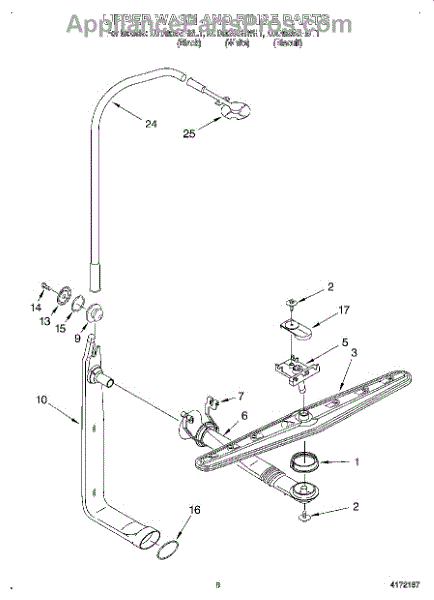

Parts for Kitchenaid KUDM25SHBT1: 07 - Upper Wash And Rinse Parts

The Ring Bearing is an OEM part for Whirlpool dishwashers. It is a critical component that supports the rotation of the dishwasher's spray arm, ensuring it can spin freely to distribute water evenly throughout the dishwasher for effective cleaning.
You should replace the ring bearing if it becomes worn out, cracked, or damaged. Causes of a bad ring bearing can include general wear and tear from regular use, accumulation of debris or mineral deposits, and damage from improperly loaded dishes.
Symptoms of a bad ring bearing include:
  • The spray arm not rotating properly
  • Ineffective cleaning performance
  • Unusual noises such as grinding or squeaking during operation
  • Loose or wobbly spray arm
This OEM part is also compatible with certain models of Maytag, KitchenAid, Jenn-Air, Amana, Magic Chef, Admiral, Norge, Roper, and Kenmore dishwashers.

The Screw is an OEM part for Whirlpool dishwashers. It secures the spray arm to the dishwasher, ensuring it rotates properly to distribute water evenly throughout the dishwasher during cleaning cycles.
Common causes of a faulty spray arm screw include wear and tear from regular use, corrosion from exposure to water and detergents, or damage from improper installation or removal.
Symptoms of a bad spray arm screw include:
  • The spray arm not rotating or functioning correctly
  • Unusual noises coming from the spray arm during operation
  • Poor cleaning performance due to inadequate water distribution

The Spray Arm and Supply Tube Kit is an OEM replacement part for Whirlpool and KitchenAid dishwashers. This kit restores two key cleaning mechanisms by replacing lower spray arms as well as its feed tubes.
This kit includes:
  • An 18-inch upper spray arm
  • A holder or hanger
  • A single-piece water supply tube
  • A split-ring seal
  • A screw
Causes of failure can include mineral deposits clogging small jet openings plus years of constant high-pressure water exposure creating small fractures in rigid plastic arms.
Symptoms of a failed spray system include:
  • Greasy or soiled dishes despite washing
  • Diminished water pressure observed inside the dishwasher
  • Visible cracks or missing spray jets on arm vanes
  • Leaks from worn tube connections to spray arms
This OEM replacement part is compatible with Maytag, Jenn-Air and Amana models as well.

The Upper Spray Arm Mount is an OEM part for Whirlpool dishwashers. This component serves as a crucial connection point between the upper spray arm and the water supply tube within the dishwasher. The mount is designed to ensure the spray arm is securely attached and positioned correctly to distribute water evenly throughout the dishwasher during cycles.
Symptoms of a bad Upper Spray Arm Mount include:
  • The spray arm becoming loose or falling off during operation.
  • Inadequate water distribution leading to poorly cleaned dishes.
  • Noticeable water leakage from the mount area during cycles.
  • Visible wear or damage to the mount, such as cracks or breakage.
Causes of a bad upper spray arm mount can include mechanical stress from the rotation and water pressure, material fatigue over time, or damage from impact during loading and unloading of dishes.
This part is also compatible with Maytag, KitchenAid, Jenn-Air, Amana, Magic Chef, Admiral, Norge, Roper, and Kenmore models.
PLEASE NOTE: Shaft is angled to match the bottom side of rack and mounts directly to the rack. On older design models part number WP8268812 will no longer be used.

This is the dishwasher manifold tube only. It attaches to the bottom of the upper rack. For the complete kit order 675808. Also consider checking the mount that attaches this manifold tube to the dishrack. For the mount order WP8539324.

Dishwasher middle wash arm manifold tube holder. This holder will have a split at the 3:00 position for easy removal from the manifold tube.

Includes screw, washer, and connector gasket.

This is an upper spray arm mount that is a part of many types of dishwashers. The upper spray arm mount attaches the water supply manifold to the spray arm. This ensures that the water moves from the manifold into the spray arm so it can be used to spray water across dishes during a cycle. If the upper spray arm mount becomes damaged or cracked, it can cause the upper spray arm to fall off. This could create additional damage so the upper spray arm mount should be replaced.If the upper spray arm mount needs to be replaced, it can be done with the help of a 5/16-inch screwdriver. First, make sure the dishwasher is unplugged and the water supply has been turned off. Open up the door to the dishwasher and locate the upper spray arm. The mount will be attached to it. Use the screwdriver to remove it and install the new part.This is an authentic OEM replacement part that is directly sourced from the manufacturer. It is sold as an individual component. The upper spray arm mount is made to be compatible with dishwashers manufactured by Inglis, Kenmore, KitchenAid, and Whirlpool.
