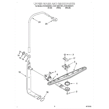

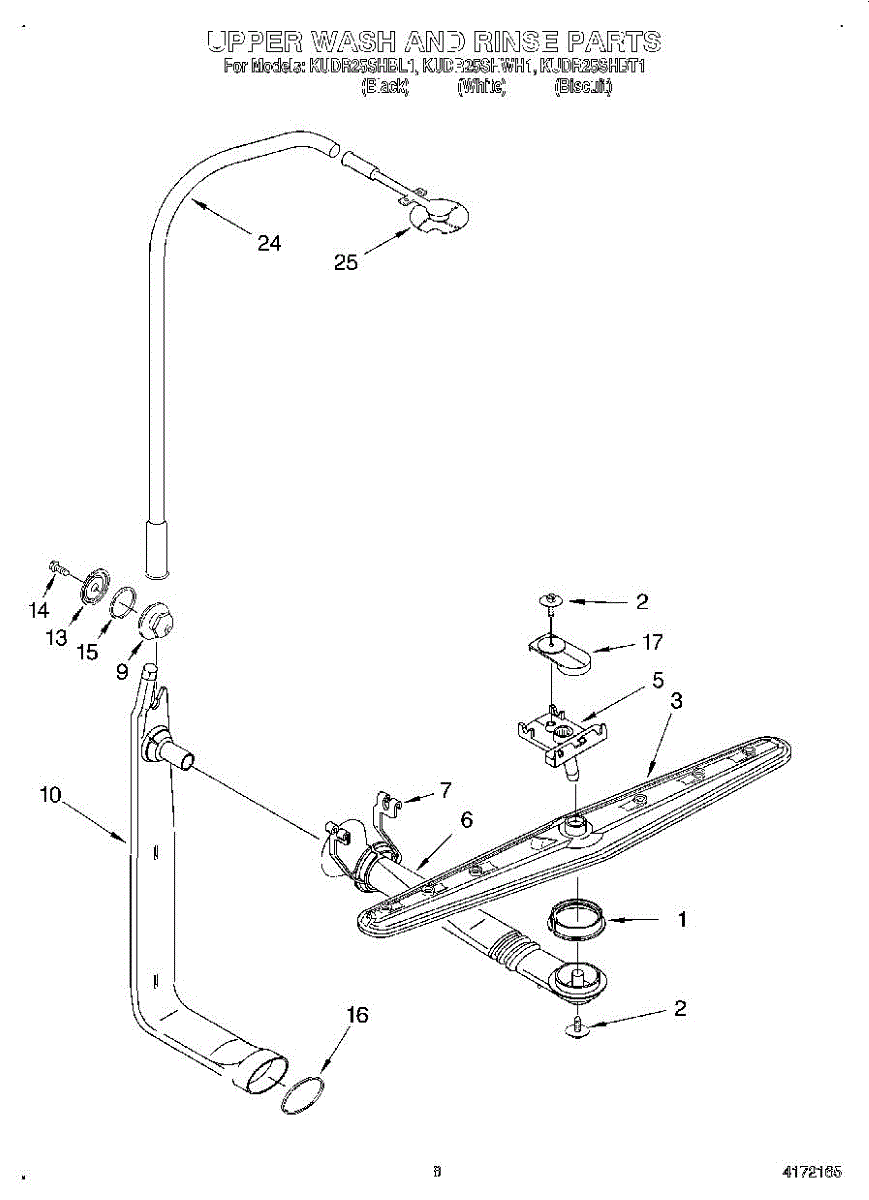

Parts for Kitchenaid KUDR25SHBL1: 07 - Upper Wash And Rinse Parts
