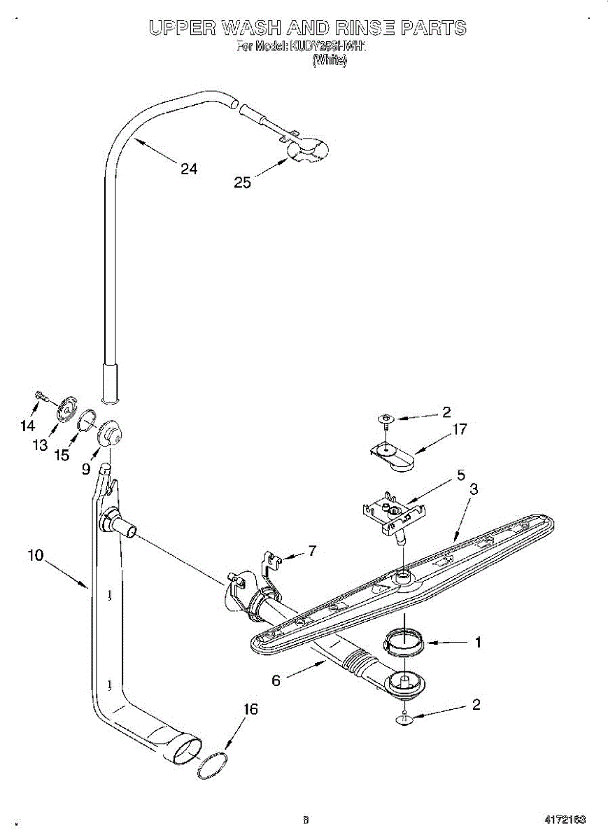

Parts for Kitchenaid KUDY25SHWH1: 07 - Upper Wash And Rinse Parts

The Ring Bearing is an OEM part for Whirlpool dishwashers. It is a critical component that supports the rotation of the dishwasher's spray arm, ensuring it can spin freely to distribute water evenly throughout the dishwasher for effective cleaning.
You should replace the ring bearing if it becomes worn out, cracked, or damaged. Causes of a bad ring bearing can include general wear and tear from regular use, accumulation of debris or mineral deposits, and damage from improperly loaded dishes.
Symptoms of a bad ring bearing include:
  • The spray arm not rotating properly
  • Ineffective cleaning performance
  • Unusual noises such as grinding or squeaking during operation
  • Loose or wobbly spray arm
This OEM part is also compatible with certain models of Maytag, KitchenAid, Jenn-Air, Amana, Magic Chef, Admiral, Norge, Roper, and Kenmore dishwashers.

The Screw is an OEM part for Whirlpool dishwashers. It secures the spray arm to the dishwasher, ensuring it rotates properly to distribute water evenly throughout the dishwasher during cleaning cycles.
Common causes of a faulty spray arm screw include wear and tear from regular use, corrosion from exposure to water and detergents, or damage from improper installation or removal.
Symptoms of a bad spray arm screw include:
  • The spray arm not rotating or functioning correctly
  • Unusual noises coming from the spray arm during operation
  • Poor cleaning performance due to inadequate water distribution

The Upper Spray Arm Mount is an OEM part for Whirlpool dishwashers. This component serves as a crucial connection point between the upper spray arm and the water supply tube within the dishwasher. The mount is designed to ensure the spray arm is securely attached and positioned correctly to distribute water evenly throughout the dishwasher during cycles.
Symptoms of a bad Upper Spray Arm Mount include:
  • The spray arm becoming loose or falling off during operation.
  • Inadequate water distribution leading to poorly cleaned dishes.
  • Noticeable water leakage from the mount area during cycles.
  • Visible wear or damage to the mount, such as cracks or breakage.
Causes of a bad upper spray arm mount can include mechanical stress from the rotation and water pressure, material fatigue over time, or damage from impact during loading and unloading of dishes.
This part is also compatible with Maytag, KitchenAid, Jenn-Air, Amana, Magic Chef, Admiral, Norge, Roper, and Kenmore models.
PLEASE NOTE: Shaft is angled to match the bottom side of rack and mounts directly to the rack. On older design models part number WP8268812 will no longer be used.

This is the dishwasher manifold tube only. It attaches to the bottom of the upper rack. For the complete kit order 675808. Also consider checking the mount that attaches this manifold tube to the dishrack. For the mount order WP8539324.

Dishwasher middle wash arm manifold tube holder. This holder will have a split at the 3:00 position for easy removal from the manifold tube.

Includes screw, washer, and connector gasket.
