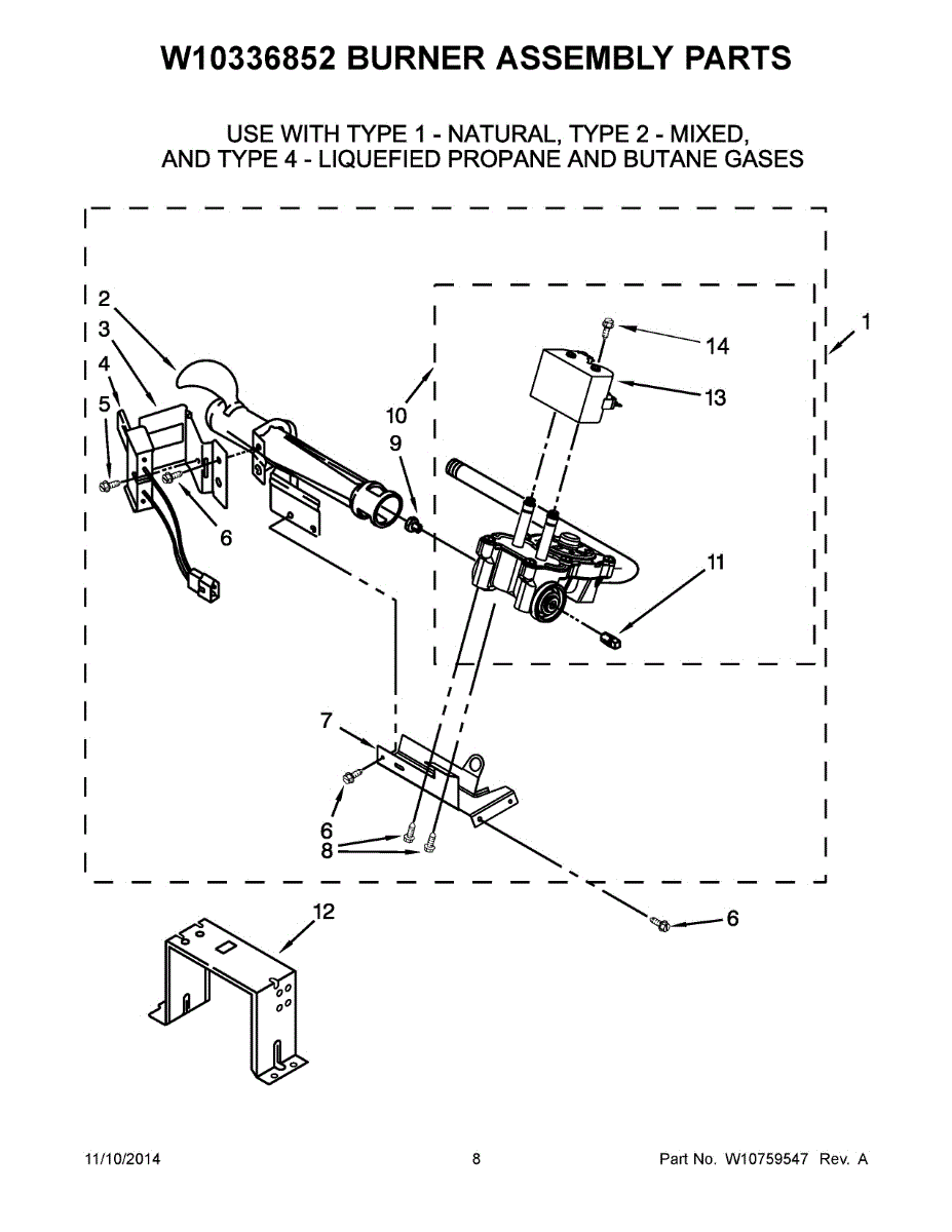

This burner tube channels the gas-air mixture to the burner and includes an adjustable air shutter to set proper combustion. Replacing a damaged assembly helps restore reliable ignition, stable flame, and consistent heating performance.
  • Directs the fuel/air mixture from the gas valve to the burner port
  • Integrated adjustable shutter regulates primary air for proper flame
  • Helps maintain efficient heat output and reliable burner operation
  • Failure can present as no or intermittent heat, burner that lights then goes out, yellow/lazy flame, or soot
What's included: One burner tube with attached adjustable air shutter Install notes:
  • Disconnect power and shut off the gas supply; allow the appliance to cool before servicing
  • Access the burner compartment and transfer any clips/brackets from the original tube
  • Note the current shutter position; after installation, adjust for a steady blue flame
  • After reassembly, leak-test gas connections with a soap solution and verify burner operation

This bracket is used to attach and is included in the igniter kit. Save money by ordering the igniter kit 279311.

The Igniter Kit and Bracket is an OEM replacement part for Whirlpool dryers. It is a kit that includes the igniter and bracket assembly, which work together to ignite the gas or electric heating element.
Causes of a bad igniter and bracket can include failure due to prolonged or repeated use, damage from impact or mishandling, or failure of integrated electronic components.
Symptoms of a bad igniter and bracket include:
  • The dryer not heating or heating intermittently
  • Repeated trips of the thermal fuse
  • Smell of gas indicating improper ignition
  • Visible damage or cracks in the igniter or bracket
This Whirlpool replacement part is also compatible with Maytag, KitchenAid, Jenn-Air, Amana, Magic Chef, Admiral, Norge, Roper, and some Kenmore models.

The Natural Gas Orifice is an OEM replacement part for Whirlpool gas dryers. Installed within the dryer burner assembly, it regulates gas fuel flow into the burner.
Common causes relate to natural deposits obstructing the small gas port, as well wear inducing intermittent ignition of flames during many years of laundering cycles.
Symptoms of a failed orifice include:
  • Slow or inefficient drying times and extended cycles
  • Uneven or incomplete drying of loads
  • Changes in flame appearance like higher than normal yellow tips

This replacement gas valve controls gas flow to the burner in a gas dryer, enabling safe ignition and consistent heat. When it fails, the burner may not light and loads can stay damp; replacing it restores proper drying performance.
  • Opens and closes gas flow to the burner when heat is called for
  • Shuts off gas when the cycle ends or heating is not active
  • Common symptoms: dryer runs but has no heat or the burner never ignites
  • May present as the ignitor glowing or clicking repeatedly without flame, or intermittent heat
What's included: One gas valve assembly. Install notes:
  • Disconnect power and shut off the gas supply before servicing
  • Work in a ventilated area and allow the dryer and burner to cool
  • Use only gas-rated thread sealant on threaded connections
  • After installation, turn on gas and check all joints for leaks with a soap-and-water solution
For gas dryers only.

The Gas Valve Coils are OEM parts for Whirlpool dryers. These coils are integral to the operation of gas dryers, controlling the flow of gas to the burner. When electrical signals are sent to the coils, they open the valve to allow gas to flow and be ignited, producing heat for drying clothes.
Over time, these coils can fail due to wear or electrical issues, leading to symptoms such as no heat or insufficient heating in the dryer, even though it runs.
Symptoms of faulty gas valve coils include:
  • Inconsistent or intermittent heating ability
  • Failure to ignite or irregular flame patterns
  • Gas valve clicking noises without burner ignition
  • Coil wires compromised, brittle or showing exposed conductors
