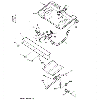

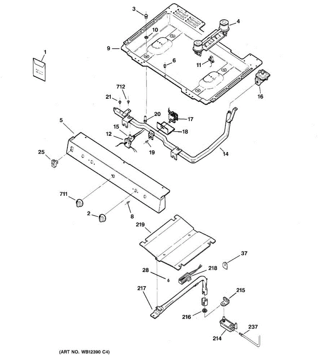

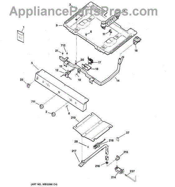

Parts for Ge RGB526PEA3CT: 01 - Gas & Burner Parts
Anti-tip kit.
$31.95
$37.70
$5.75
Natural gas orifice spud.
$25.90
$3.95
This replacement orifice spud for the cooktop surface burner threads into the orifice holder to meter gas flow, helping ensure proper flame size and reliable ignition for consistent cooking performance. What it does:
  • Meters gas flow to the surface burner through a calibrated opening
  • Helps produce stable, properly sized flames for even cooking
  • Replace if the original spud is clogged, stripped, or damaged
  • Common symptoms include weak/low or no flame, yellow/orange flames, uneven heating, or delayed ignition
  • 1 orifice spud
  • Turn off the gas supply and disconnect power; allow the appliance to cool completely
  • Remove grates, burner caps, and burner heads to access the orifice holder
  • Use the correct spud for the specific burner position and gas type per your model documentation
  • Start threads by hand and tighten snugly without overtightening; after reassembly, check for leaks with a soapy-water solution and verify ignition and flame
$16.74
$2.79
5.0 (45)
The Double Burner Kit is an OEM part for GE gas ranges. This kit includes the necessary components to replace the double burner, which is crucial for efficient cooking on GE gas stoves. The double burner provides two separate flame sources, allowing for versatile cooking options with different heat levels.
Causes of a bad double burner can include normal wear and tear, clogs from food debris, exposure to high temperatures, or physical damage. These issues can hinder the burner's performance and safety.
Symptoms of a bad double burner include:
  • Uneven or weak flames
  • One or both burners not igniting
  • Difficulty in adjusting the flame size
  • Noticeable gas odor when the burner is off
$55.95
$68.17
$12.22
$67.95
$100.18
$32.23
Size: 8 - 32 inch.
$31.70
$51.95
$61.30
$9.35
This surface burner spark electrode creates the electric arc that lights the gas at the burner. Replacing a worn electrode restores consistent, reliable ignition.
  • Generates a high-voltage spark at the burner head to ignite gas
  • Helps ensure quick, repeatable lighting when the knob is turned to Lite
  • Common symptoms: burner won't light, intermittent or weak spark, delayed ignition, lights only with a match
  • If other burners spark normally, the affected burner's electrode is a common culprit
What's included: 1 spark electrode Install notes:
  • Disconnect power and shut off gas before servicing
  • Handle the ceramic insulator carefully to avoid cracking
  • Match the new electrode's tip position and gap to the original; transfer mounting hardware as needed
  • Route the ignition wire away from heat/sharp edges, ensure a firm connection, then reassemble and test ignition
$13.03
$2.08
Note: Part has been revised and may no longer include the wires. The switch is the same. Use your existing wires.
$51.95
$62.34
$10.39
$44.15
$62.07
$17.92
A surface burner valve that regulates gas flow to a cooktop/range burner, allowing precise flame adjustment and complete shutoff. Replace a worn valve to restore smooth knob feel, accurate flame control, and dependable ignition.
  • Controls gas flow to one surface burner on the valve manifold
  • Interfaces with the control knob to open/close and set flame level
  • Worn valves can cause gas odor, stiff/loose knob action, or erratic flame
  • Common symptoms: burner won't light, flame stuck high/low, or burner won't shut off
What's included: 1 surface burner valve Install notes:
  • Disconnect electrical power and shut off gas supply before servicing
  • Remove burner knobs and front panel/cooktop to access the valve manifold
  • Transfer fittings/orifice holder as needed; install the new valve in the same orientation
  • After reassembly, restore gas and check all connections for leaks with approved solution; verify ignition and flame adjustment
$23.95
$28.74
$4.79
This gas pressure regulator reduces and stabilizes the supply gas to the appliance's manifold, helping ensure steady burner flames and safe, consistent heating. Replacing a faulty regulator can restore reliable ignition and oven performance.
  • Reduces incoming line pressure to the specified manifold pressure for proper burner operation
  • Maintains consistent flame height and heat output across burners
  • Helps address flame surging or fluctuation when other gas appliances in the home turn on
What's included: 1 gas pressure regulator Install notes:
  • Turn off gas supply and power before servicing; installation by a qualified person is recommended
  • Follow the flow-direction arrow on the body and ensure proper mounting orientation
  • Use approved pipe thread sealant on NPT threads only; do not use sealant on flare connections
  • After installation, leak-test all joints with a non-corrosive solution and verify burner operation/manifold pressure per the service manual
$59.95
$71.34
$11.39
4.9 (49)
The Oven Thermostat is an OEM part for GE ovens. This thermostat is a component in regulating the oven's heat, turning the heat on and off to maintain the desired temperature setting. With its precise calibration and durable construction, the oven thermostat is essential for achieving consistent cooking outcomes and preventing overheating, which could lead to burnt or undercooked food.
Causes of a bad oven thermostat include prolonged use, which can affect its sensitivity, and exposure to extreme temperatures, which may impact its accuracy.
Symptoms of a bad Oven Thermostat include:
  • The oven not reaching the set temperature
  • Oven temperature fluctuating too widely from the desired setting
  • Food not cooking evenly or within expected time frames
$150.63
$177.74
$27.11
This is a replacement mounting screw for the refrigerator/freezer thermostat assembly. It secures the thermostat to the cabinet so temperature sensing and control remain stable and reliable. What it does:
  • Secures the thermostat housing or bracket to the appliance cabinet
  • Keeps the thermostat properly positioned for accurate temperature sensing
  • Common fix when a loose, missing, or stripped thermostat fastener causes rattling or poor contact
  • Small hardware part used during thermostat replacement or reassembly
  • One thermostat mounting screw
  • Turn off power to the appliance before starting any repair
  • Use appropriate screwdriver and do not overtighten to avoid stripping the housing or threads
  • If original hole or threads are damaged, inspect bracket or cabinet and replace as needed
$6.72
$1.64
Location: Right rear.
$22.95
$27.31
$4.36
Location: Left rear.
$47.95
$61.80
$13.85
Location: Right front.
$30.88
$4.93
Location: Left front.
$47.95
$61.80
$13.85
This is the screw that secures the burner valve to the appliance, keeping the valve and associated controls fastened for reliable operation. Replaces a worn or missing mounting fastener to restore proper valve alignment and support. What it does:
  • Secures the burner valve assembly to the appliance frame or manifold
  • Keeps valve position stable to help maintain reliable burner operation
  • Helps prevent movement that can cause loose connections or intermittent function
  • Used when original screw is stripped, missing, or corroded
  • One burner valve mounting screw
  • Turn off power and gas supply to the appliance before starting any repair
  • Use the correct size driver and avoid over-tightening to prevent stripping the screw or damaging the valve
  • Confirm valve and surrounding components are properly aligned before final tightening
$6.72
$1.64
Color: Black
4.8 (18)
The Igniter Mounting Screw is an OEM replacement part for GE ovens and ranges. This screw secures the igniter to the burner assembly, ensuring it remains firmly in place for consistent and reliable ignition. Its precise fit and durable design help maintain the stability and functionality of the igniter.
Over time, mounting screws can become corroded, stripped, or lost during repairs or maintenance. A missing or damaged screw may result in a loose igniter, affecting the appliance's ability to ignite properly.
Symptoms of a bad or missing igniter mounting screw include:
  • The igniter becoming loose or misaligned
  • Difficulty securing the igniter during installation or repair
  • The burner fails to ignite reliably or consistently
  • Increased noise or movement of the igniter during operation
$11.34
$13.49
$2.15
This igniter cover is a replacement protective shield that helps protect the oven igniter from food spills and debris, extending the igniter's service life and helping the burner ignite reliably. What it does:
  • Shields the oven igniter from direct contact with spills, drips and falling debris
  • Helps prevent premature igniter damage that can lead to ignition problems
  • Can reduce the chance of shorting or erratic ignition caused by contamination
  • Matches original shape to ensure proper fit and clearance around the igniter
What's included: One igniter cover Install notes:
  • Disconnect power to the appliance (and shut off gas if applicable) before servicing
  • Allow the oven to cool completely and wear gloves to avoid cuts from sheet metal
  • Handle the igniter and cover carefully; avoid touching the igniter surface directly
  • Test appliance operation after reinstall
$15.59
$18.40
$2.81
214
4.8 (11)
This GE Oven Safety Valve is an OEM replacement part for GE ranges. The part's primary function is to prevent gas from releasing until the igniter has received enough voltage to ignite it safely. Not allowing any gas to exit before ignition helps avoid potential safety hazards from uncombusted gas.
Causes for failure could include wear and corrosion over many years of use. Repeated heating and cooling stresses may cause cracking or breaking in the valve's delicate regulating components. Mineral deposits or dirt buildup may also obstruct proper opening and closing.
Symptoms of a faulty safety valve would include:
  • gas releasing or leaking even when the igniter is not lit
  • the oven or burners not lighting at all when the valve is engaged
This GE OEM part is also compatible with Hotpoint, RCA and select Kenmore models.
$125.33
$151.44
$26.11
215
This oven safety valve bracket secures the gas safety valve in place to keep the valve aligned and stable during operation. It replaces a worn, bent, or broken bracket to help maintain safe, consistent gas valve positioning. What it does:
  • Holds the oven gas safety valve securely to the chassis to prevent movement or misalignment
  • Helps maintain consistent valve positioning for reliable burner operation
  • Commonly replaced when the bracket is cracked, bent, or missing hardware
- What's included: One oven safety valve bracket. Install notes:
  • Always shut off gas supply and disconnect power before servicing gas components
  • Remove access panels to reach the valve; retain all fasteners for reassembly
  • Check valve alignment and gas connections after installation; do not overtighten mounting hardware
216
217
4.9 (19)
The Oven Bake Burner is an OEM part for GE gas ovens. It is responsible for providing the heat necessary for baking by distributing an even flame across the oven cavity. This burner tube measures approximately 20" in total length and 6" in height. This burner is compatible with both liquid propane (LP) and natural gas (NG) setups, with the settings determined by the regulator.
Causes of a bad oven bake burner can include wear and tear from frequent use, clogging from food debris or grease, or damage from exposure to high temperatures. A malfunctioning burner can lead to uneven cooking and longer baking times.
Symptoms of a bad Oven Bake Burner include:
  • Uneven baking or cooking results
  • Weak or no flame when the bake function is activated
  • Delayed ignition or clicking sounds without ignition
  • Unusual smells or visible damage to the burner
$38.44
$46.13
$7.69
218
4.9 (710)
The Oven Igniter is an OEM replacement part for GE ovens, designed to ignite the bake igniter to start the heating process. This part is responsible for creating the spark that ignites the gas, providing the heat needed to cook and bake food. Over time, the oven igniter can wear out or become damaged, which can prevent the oven from heating.
Symptoms of a bad Oven Igniter include:
  • The oven not heating up at all.
  • The oven taking longer than normal to heat.
  • Gas smell in the oven due to gas being released without ignition.
  • A clicking sound without the oven igniting.
Causes of a bad igniter can include normal wear and tear over time, exposure to excessive heat or moisture, or physical damage from impact or mishandling.
IMPORTANT: The connector plug may need to be cut off and igniter wires connected to range wires using porcelain wire connectors.
$55.77
$98.14
$42.37
219
237
This tube routes water from the refrigerator's water valve to the dispenser or ice system, restoring proper water flow and stopping leaks when a cracked or clogged supply tube is the issue. Easy direct replacement for affected lines. What it does
  • Carries water from the valve to the dispenser or ice maker so the appliance can fill and dispense properly.
  • Commonly replaced when you see leaks at fittings, a puddle under the fridge, or a visibly cracked or split tube.
  • Can restore normal water flow when the line is pinched, kinked, or partially obstructed.
  • Works with factory fittings and clamps used on the valve-to-ice maker/dispenser connection.
What's included One tube. Install notes
  • Turn off the refrigerator's water supply and unplug the appliance before starting; drain remaining water from the line.
  • Inspect fittings for damage; loosen or remove existing clamps/fittings to swap the tube, then secure new tube and clamps to prevent leaks.
  • After installation, restore water and power, check all connections for leaks, and run the dispenser/ice maker briefly to confirm proper flow.
$48.57
$57.45
$8.88
711
712
$6.72
$1.64
