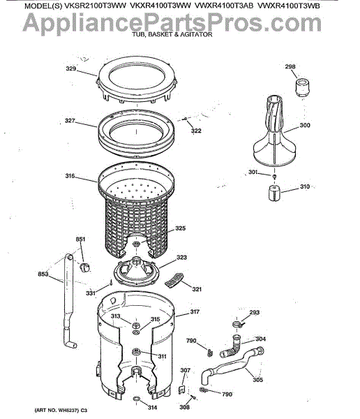

Parts for Ge VKSR2100T3WW: 03 - Tub, Basket & Agitator Parts
293
298
5.0 (25)
Fabric softener not dispensing or agitator loose? This washer dispenser cup sits atop the agitator. Simple DIY fix—twist off and replace in minutes.
$25.07
$7.12
300
4.9 (28)
The Agitator Assembly is an OEM part for GE washing machines. This part moves clothes through the water and detergent during the wash cycle. This part ensures thorough cleaning by creating the necessary motion to distribute and cleanse laundry evenly.
Causes of a bad Agitator Assembly can range from wear and tear over extended use, to damage from overloading the washing machine, or even issues with the drive mechanism that powers the agitator's motion.
Symptoms of a bad Agitator Assembly include:
  • Clothes coming out of the wash still dirty or not as clean as expected
  • The washing machine making unusual noises during the wash cycle
  • The agitator not moving during the cycle or moving erratically
301
5.0 (297)
Washer won't agitate or makes squeaking noise? The agitator coupler transmits motor force to spin clothes. DIY repair in 15 minutes with video guide.
$22.95
$27.31
$4.36
304
5.0 (31)
Drain pump inlet hose for top-load washers. Connects the tub to the pump assembly. Replace if cracked, leaking, or has holes causing water on the floor.
$12.37
$14.71
$2.34
305
4.9 (9)
The Drain Hose is an OEM part for GE washing machines. It is specifically designed to channel used water out of the washer and into the household drainage system.
Causes of a bad drain hose can include physical damage from movement or installation, clogging from lint and debris, or degradation of the hose material over time, leading to leaks and inefficiency.
Symptoms of a bad Drain Hose include:
  • Water leaking from the back or underside of the washing machine
  • Pools of water around the area where the washing machine is installed
  • Signs of wear or damage to the hose, such as cracks, holes, or bulging
307
Secures washer tub and hoses to prevent leaks and noise. Replace if worn or broken to maintain proper alignment and seal. Verify fit with your model.
$6.72
$1.64
308
Secures the agitator assembly to the drive shaft in top-load washers. Replace if stripped, rusted, or missing during agitator repairs or removal.
$4.43
$3.93
310
5.0 (297)
$22.95
$27.31
$4.36
311
4.8 (122)
Prevents water leaks between the washer tub and transmission. Replace if you notice water leaking from the base during wash cycles. Verify fit by model.
$13.14
$2.19
313
4.8 (122)
This tub-bearing split ring is an OEM replacement part designed for GE washing machines. This part measures 2 inches in diameter. It is positioned between the inner and outer tubs to hold the tub bearing inside the outer tub. The Tub Bearing Split Ring not only supports the tub/hub assembly but also ensures smooth operation.
Symptoms of a bad Tub Bearing Split Ring include:
  • Excessive vibration or tub imbalance during spins
  • Loud clunking, knocking or grinding sounds
  • Reduced spin speeds or inability to achieve high RPMs
  • Premature tub or bearing wear requiring replacement
Causes can be extended use over time which leads to wear and fatigue of the split ring material. Cracks or breaks can develop, reducing its stability and load-bearing capacity.
This genuine GE replacement part is also compatible with Hotpoint, RCA and some Kenmore front-load models.
NOTE: For the washer outer tub seal order WH02X10383.
314
4.7 (100)
Replacement tub bearing for top-load washers. Fixes grinding, roaring, or loud humming noises during spin cycles. Verify fit with your model number.
$7.37
315
4.8 (61)
Hub washer fits between the transmission and inner tub in top-load washers. Replace if cracked, worn, or causing leaks during operation.
$14.34
$2.39
316
Extra large
317
Complete washer outer tub bearing and cover kit. Replace when your washer makes grinding noises or the drum wobbles. Verify fit with your model number.
$201.26
$239.50
$38.24
321
322
Baffle screw with flat washer for washers. Secures baffle or trim pieces to the washer body. Replace if screw is stripped, washer is missing, or worn.
$7.67
$0.69
323
Hub
325
4.8 (135)
Secures the inner tub to the drive mechanism in top-load washers. Replace if stripped, rusted, or won't stay tight. Reverse-threaded design.
$22.39
$9.44
327
329
Outer tub cover kit for washers. Includes bleach funnel, clamps, wire tie, and cap. Replace if cracked, broken, or missing components after repair work.
$135.95
$163.14
$27.19
331
10 - 18 pl trt 3/4 sn
$7.64
$8.40
790
Secures washer hoses at pump, tub, and valve connections to prevent leaks and hose blow-offs. Replace worn or missing clamps for a tight seal. Confirm fit.
$18.98
$3.03
851
Seals the flood/overflow hose connection to your washer tub. Replace if water seeps from the tub area or the gasket feels soft. Confirm fit by model.
$36.71
$43.32
$6.61
853
