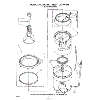

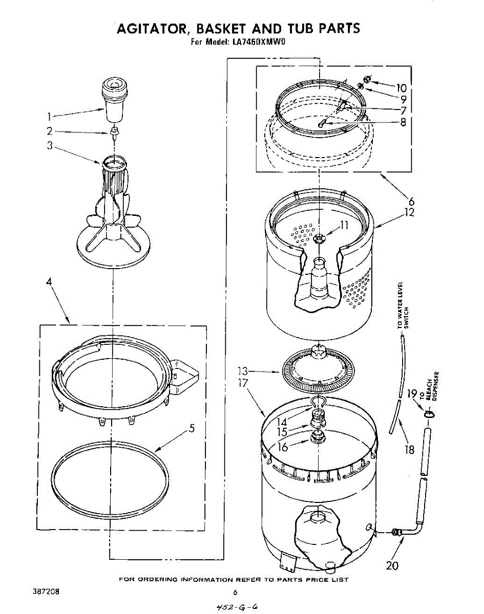

Parts for Whirlpool LA7460XMW0: 04 - Agitator, Basket And Tub Parts
