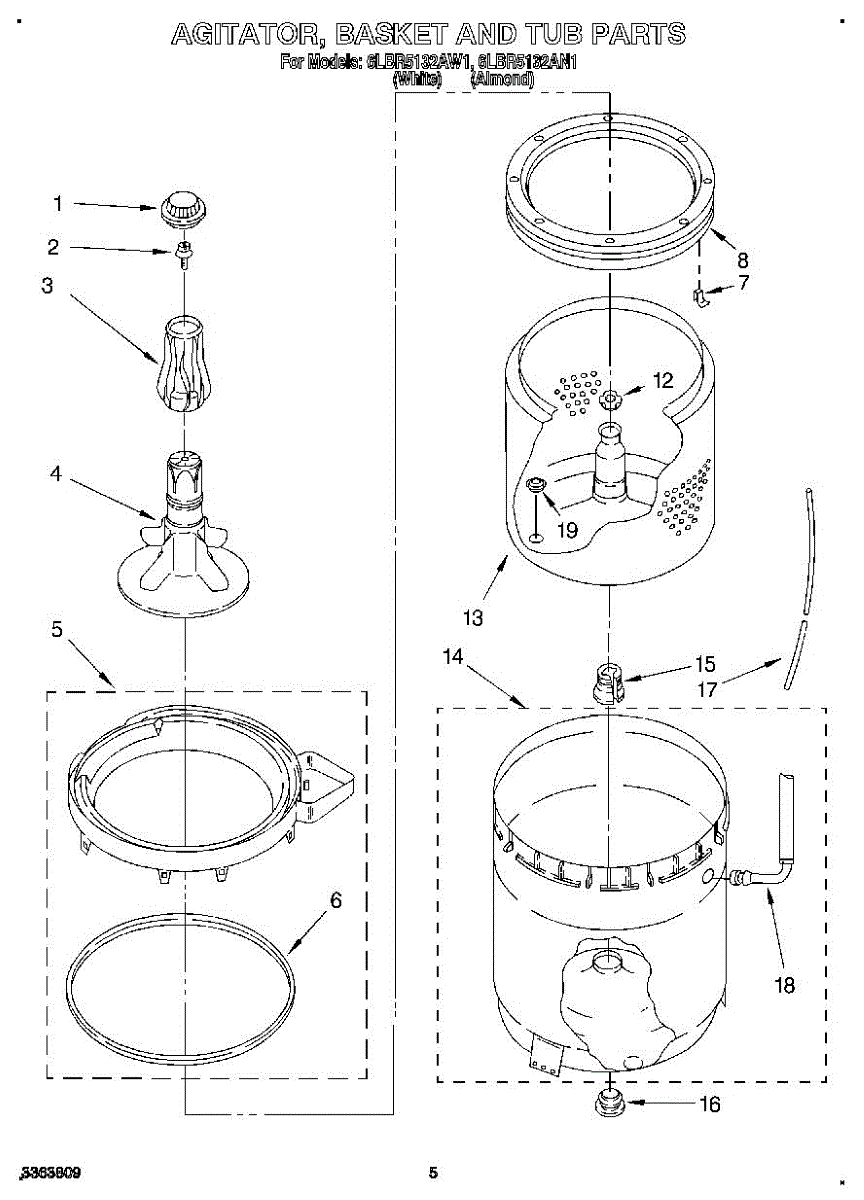

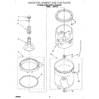

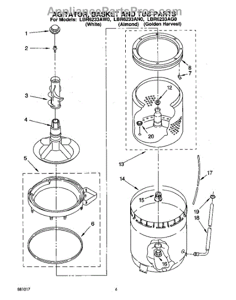

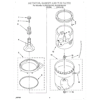

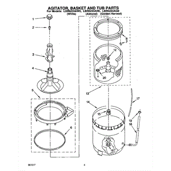

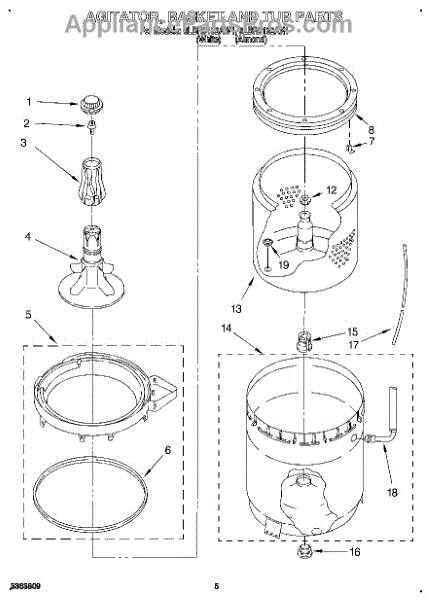

Parts for Whirlpool LBR6233AN0: 04 - Agitator, Basket And Tub Parts
