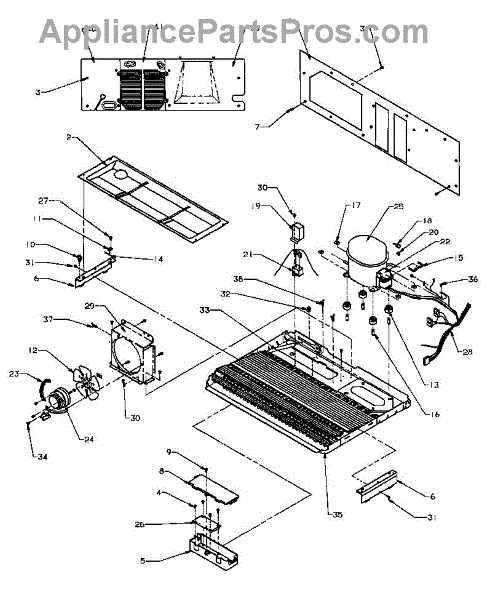

Parts for Amana SX19NW / P1168702W W: 07 - Machine Compartment Parts
