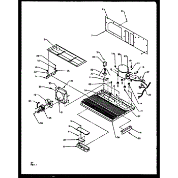

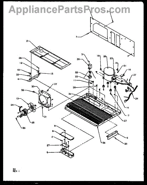

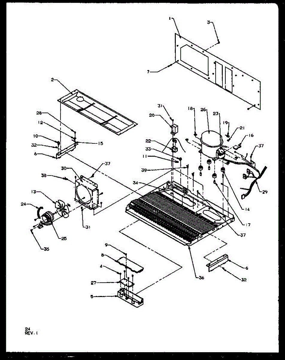

Parts for Amana SQ22NBW / P1162705W W: 08 - Machine Compartment Parts
