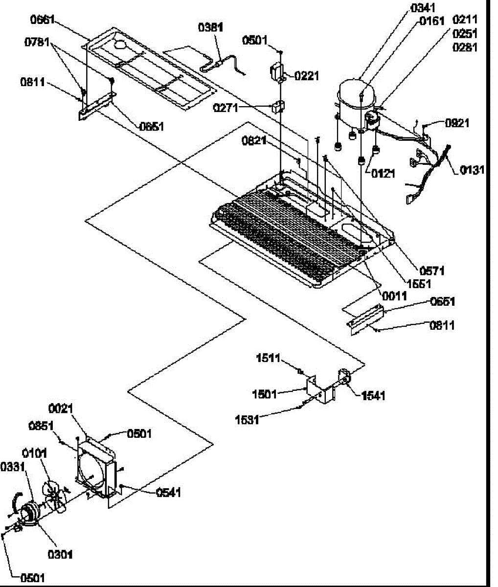

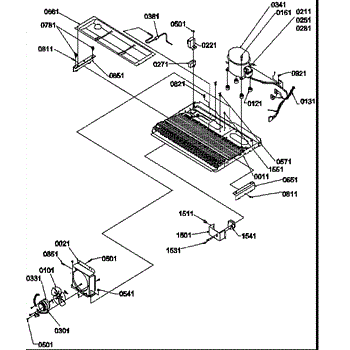

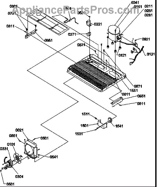

Parts for Amana 58637 / P1317501W L: 09 - Machine Compartment & Muffler Assy Parts

This grommet is a small protective seal used where a hose, tube, wire, or component passes through or mounts to the appliance cabinet. It cushions the connection and helps prevent leaks, vibration, and wear for reliable operation.
  • Provides a snug barrier between parts and metal openings to protect hoses, tubes, and wiring
  • Helps seal against moisture to reduce seepage
  • Dampens vibration and rattling noises
  • Replace if cracked, hardened, missing, or no longer stays seated; symptoms may include drips at a pass-through, buzzing/rattling, or a loose fit
What's included: 1 grommet
  • Access the grommet location and note orientation/routing
  • Remove the old grommet and clean the opening
  • Press the new grommet fully into place; reassemble and test for leaks/noise

This overload is a thermal protection device that mounts on the motor/compressor and opens the circuit when excessive heat or current is detected. Replacing a weak or failed overload helps restore safe startup and protects the windings from damage. What it does:
  • Monitors motor/compressor temperature and current draw
  • Interrupts power on overheat/overload to prevent damage
  • Aids troubleshooting of start/run issues when paired with the start device
  • Common symptoms: hums then clicks off, won't start, intermittent shutdown, frequent tripping
  • 1 thermal overload protector
  • Disconnect power before servicing; allow components to cool
  • Access the terminal area on the motor/compressor; remove any cover
  • Note/photograph wire positions; transfer wires and fully seat the new overload on the correct terminal
  • Inspect the start relay, capacitor, and terminals for heat damage; replace any compromised parts

This PTC start relay plugs onto the compressor to momentarily power the start winding and help the compressor spin up smoothly. Replacing a failed relay can stop repetitive clicking and help restore stable cooling performance. What it does:
  • Momentarily energizes the compressor's start winding at startup; the PTC element then increases resistance to take the start winding out of the circuit.
  • Helps protect against repeated hard-start attempts that cause clicking and no-cool conditions.
  • Common failure signs include repeated clicking, the compressor not starting, warm temperatures, burn marks/melted housing, or a relay that rattles when shaken.
  • Mounts directly on the compressor terminals and interfaces with the model-specific overload and cover.
  • 1 PTC start relay
  • Disconnect power and allow components to cool before servicing.
  • Access the compressor compartment; remove any cover/retainer to reach the start device.
  • Note wiring and orientation; pull the old relay straight off the compressor pins and push the new relay fully onto the pins. Reconnect wires and reinstall the cover.
  • Use only the start device specified for your exact model/compressor. If the old relay shows heat damage, inspect the matching overload and wiring for issues.

The Run Capacitor is an OEM part for Whirlpool refrigerators. It is responsible for helping the compressor motor start and run efficiently by providing an extra electrical boost. This component ensures that the refrigerator operates smoothly and maintains the correct temperature by stabilizing the compressor's performance.
Causes of a bad run capacitor can include electrical surges, age-related wear, or overheating. When the capacitor fails, the compressor may struggle to start or run continuously, leading to inefficient cooling or a non-functional refrigerator.
Symptoms of a bad run capacitor include:
  • The refrigerator not cooling properly
  • The compressor not starting or running intermittently
  • Unusual clicking noises from the refrigerator

This OEM Replacement Part is a high-quality, 2-watt condenser fan motor for Whirlpool refrigerators.The motor is designed to optimize your refrigerator's cooling performance. This 115-volt motor operates with a clockwise rotation.
Symptoms of a bad condenser fan motor kit include:
  • Gradual rise in interior freezer temperatures
  • Inability to maintain consistent cooling performance
  • Loud buzzing or grinding noises coming from inside
  • Tripped breakers or failure to restart after service
Causes stem from normal wear of ball bearings as the high-efficiency motor operates continuously. Exposure to dust or debris introduced through openings accelerates wear over many years of use.
This OEM part is also compatible with brands including Kenmore, KitchenAid, and Danby.

This is the refrigerator's sealed-system compressor. It pressurizes and moves refrigerant through the system to remove heat from the cabinet, restoring consistent cooling performance when the original compressor has failed or lost capacity. What it does and common symptoms:
  • Pumps and circulates refrigerant through the evaporator and condenser to remove heat
  • Maintains target temperatures in both fresh food and freezer sections
  • Symptoms of failure can include: no cool/poor cooling, unit warms up after short operation, humming then clicking from the compressor area, or repeated thermal overload trips
  • Runs but not cool effectively when the compressor is weak or internally damaged (after ruling out start components and charge issues)
  • 1 compressor
  • Disconnect power before servicing; sealed-system work involves high pressure and high temperatures
  • Sealed-system repairs require EPA Section 608 certification and specialized tools (gauges, vacuum pump, brazing equipment)
  • Replace the filter-drier, braze connections properly, evacuate to deep vacuum, and charge to the model's specification
  • Related components (start device/overload, run capacitor, controls) are tested before condemning the compressor

This timer mounting bracket secures the appliance timer assembly to the cabinet so the timer stays aligned and stable during operation. Replaces a worn or broken bracket to restore proper timer support and reduce vibration. What it does:
  • Holds the timer/timer motor firmly in place on the control panel or chassis
  • Prevents the timer from shifting or rattling during cycles
  • Helps maintain proper gear alignment for accurate cycle timing
  • Commonly replaced when bracket is bent, cracked, or missing mounting studs
  • One timer mounting bracket
  • Basic hand tools required; disconnect power before beginning repair
  • Inspect related fasteners and the timer housing for additional damage
  • Handle the timer assembly carefully to avoid damaging wiring or connectors

The Refrigerator Defrost Timer is an OEM Replacement Part designed to manage the automatic defrost system in Whirlpool freezers. Housed at the top inside of the appliance, this component shuts off the cooling system and activates the defrost heater. The timer operates at 120V 60Hz and activates for 33 minutes every 8 hours. The dial on the timer can be turned clockwise to advance it into and out of defrost.
Causes of a faulty Defrost Timer Kit can include electrical issues, mechanical wear and tear over time, or problems with the timer's internal components.
Symptoms of a bad Defrost Timer Kit include:
  • Freezer not defrosting properly, leading to excessive ice buildup
  • Refrigerator running constantly or not cooling effectively
  • Condensation or moisture issues inside the refrigerator
  • Error codes related to the defrost system

Size: 8-32 x .312 inch.
