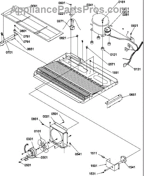

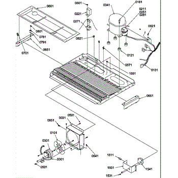

Parts for Amana SR25TL / P1194002W L: 09 - Machine Compartment Parts
