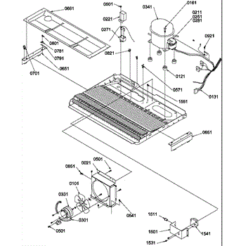

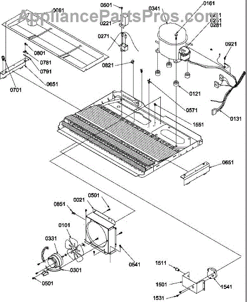

Parts for Amana SR25TW / P1194002W W: 09 - Machine Compartment Parts
