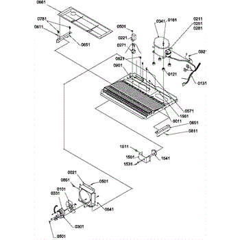

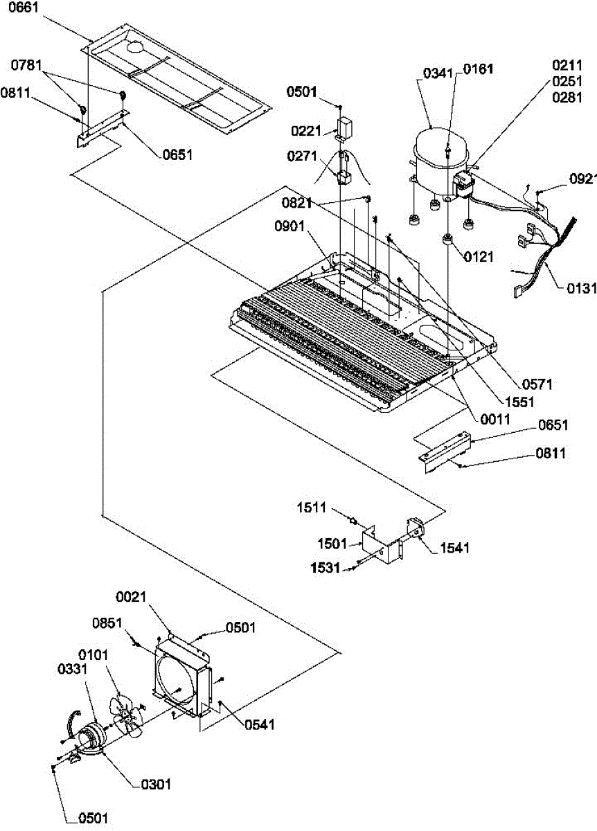

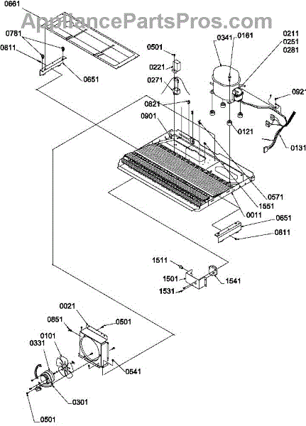

Parts for Amana SS25TL / P1194003W L: 09 - Machine Compartment Parts
