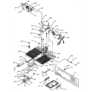

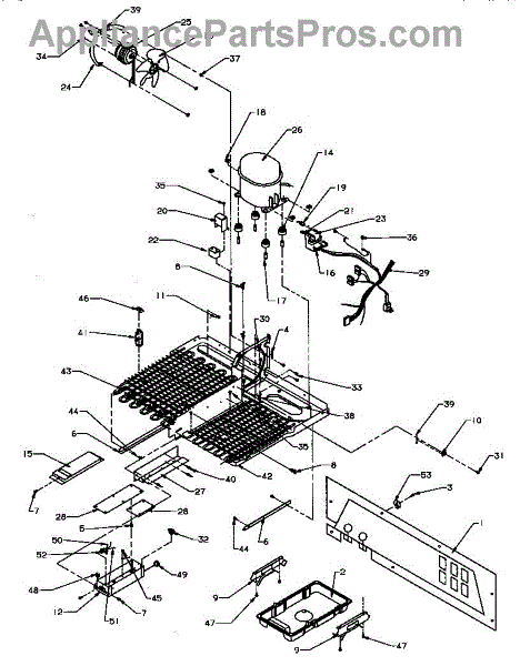

Parts for Amana GRH2203W / P1168105W W: 10 - Machine Compartment Parts
