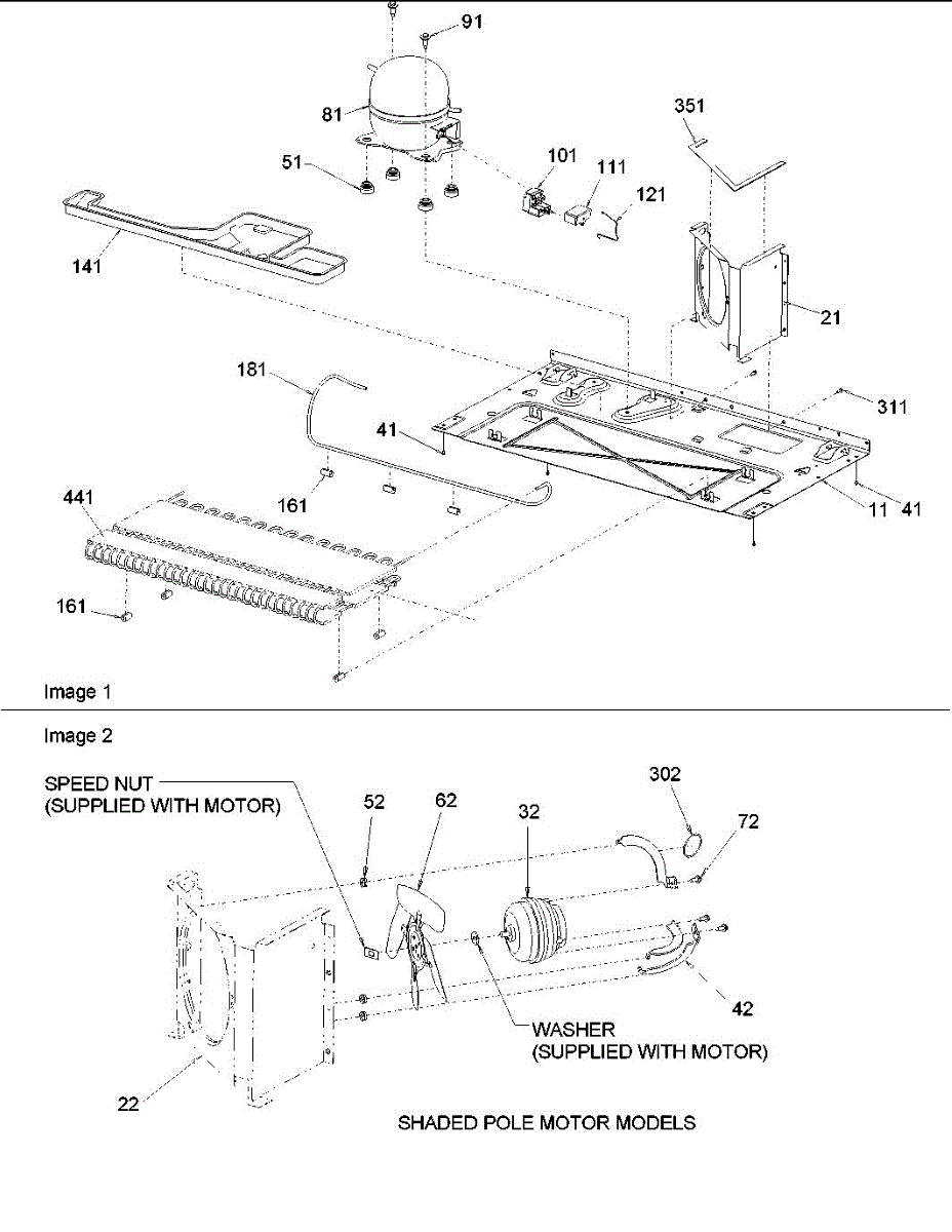

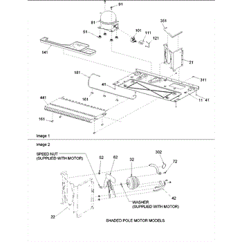

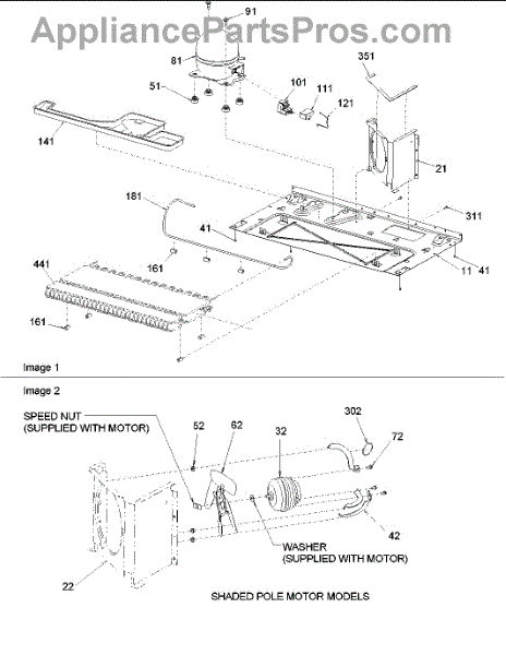

Parts for Amana ARS2664BC / PARS2664BC0: 11 - Machine Compartment Parts

This grommet is a small protective seal used where a hose, tube, wire, or component passes through or mounts to the appliance cabinet. It cushions the connection and helps prevent leaks, vibration, and wear for reliable operation.
  • Provides a snug barrier between parts and metal openings to protect hoses, tubes, and wiring
  • Helps seal against moisture to reduce seepage
  • Dampens vibration and rattling noises
  • Replace if cracked, hardened, missing, or no longer stays seated; symptoms may include drips at a pass-through, buzzing/rattling, or a loose fit
What's included: 1 grommet
  • Access the grommet location and note orientation/routing
  • Remove the old grommet and clean the opening
  • Press the new grommet fully into place; reassemble and test for leaks/noise

This condenser fan blade is the rotating plastic blade that moves air across the condenser coils to help remove heat from the refrigerator. Replacing a damaged blade restores proper airflow for more consistent cooling. What it does:
  • Spins on the condenser fan motor to circulate air over condenser coils
  • Helps dissipate heat so the compressor and fridge run efficiently
  • Can cause reduced cooling or higher temperatures if broken or missing
What's included: One condenser fan blade. Install notes:
  • Disconnect power to the appliance before starting any service
  • Inspect the fan motor shaft and mounting for wear; replace motor if shaft is damaged
  • Handle the blade carefully to avoid cracking; ensure blade is seated and secured before testing

This sealed-system compressor circulates refrigerant to cool your refrigerator, restoring normal cooling performance when the compressor fails. Designed to replace a failing compressor and help bring temperatures back to safe food-storage levels. What it does:
  • Compresses and circulates refrigerant through the sealed refrigeration circuit
  • Restores cooling when the compressor motor runs properly
  • Commonly linked to symptoms like weak or no cooling, loud humming or clattering sounds, or a refrigerator that cycles continuously
  • May be the cause if the appliance frequently trips a circuit breaker or shows hard-starting behavior
What's included: Compressor only. Install notes:
  • Sealed-system work requires certified HVAC/refrigeration service and proper refrigerant handling per local regulations
  • Disconnect power before beginning any repair; follow lockout/tagout practices
  • Compressor replacement often requires system evacuation, brazing, and recharge — do not attempt unless qualified
  • Use the identical replacement part number and follow OEM service instructions to avoid damage

The Relay and Overload is an OEM replacement part for Whirlpool refrigerators. These electronic components regulate key refrigerator operations and safety measures. The relay controls the start and stop of refrigeration components like the compressor and condenser fan motor.
Symptoms of a bad relay and overload include:
  • Refrigerator failing to consistently cool or maintain temperature
  • Buzzing or humming noises coming from cooling areas
  • Tripped circuit breakers
Causes can include defective relay contacts, a burned-out overload, or worn-out electrical components internal to either part.
This OEM Whirlpool replacement is also compatible with Maytag, KitchenAid, Jenn-Air, Amana, Magic Chef, and select Kenmore fridge models as well.

The Run Capacitor is an OEM part for Whirlpool refrigerators. It is responsible for helping the compressor motor start and run efficiently by providing an extra electrical boost. This component ensures that the refrigerator operates smoothly and maintains the correct temperature by stabilizing the compressor's performance.
Causes of a bad run capacitor can include electrical surges, age-related wear, or overheating. When the capacitor fails, the compressor may struggle to start or run continuously, leading to inefficient cooling or a non-functional refrigerator.
Symptoms of a bad run capacitor include:
  • The refrigerator not cooling properly
  • The compressor not starting or running intermittently
  • Unusual clicking noises from the refrigerator

This condenser grommet cushions and secures the refrigerator condenser assembly, reducing vibration and preventing metal-to-metal contact. It helps keep the condenser stable for quieter operation and longer component life. What it does:
  • Isolates condenser from the cabinet to reduce rattling and vibration noise
  • Prevents condenser edges from rubbing or wearing against the chassis
  • Helps maintain proper condenser alignment for efficient airflow
  • Commonly replaced when cracked, torn, or missing and causing noise or movement
What's included: One condenser grommet. Install notes:
  • Disconnect power before servicing the appliance.
  • Support the condenser assembly before removing or installing the grommet to avoid stress on tubing.
  • Push the grommet into position; replace any grommets that are brittle or deformed.

This seal strip replaces a worn or damaged door gasket edge to restore a proper seal and help the appliance maintain temperature and operate quietly. It's a direct-fit service part used where a continuous seal is required. What it does:
  • Provides a flexible barrier along the door/frame to reduce air leaks and heat/cold loss
  • Helps prevent moisture buildup and improves energy efficiency when sealing is restored
  • Reduces rattling and vibration caused by a compressed or torn seal edge
  • Commonly replaced when the strip is torn, missing, or no longer adheres properly
  • One seal strip
  • Disconnect power to the appliance before servicing to avoid electrical or burn hazards
  • Clean and dry the mounting surface; remove old adhesive or residue for best adhesion
  • Align the strip carefully and press firmly; allow any adhesive to cure per manufacturer instructions
