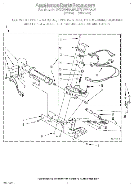

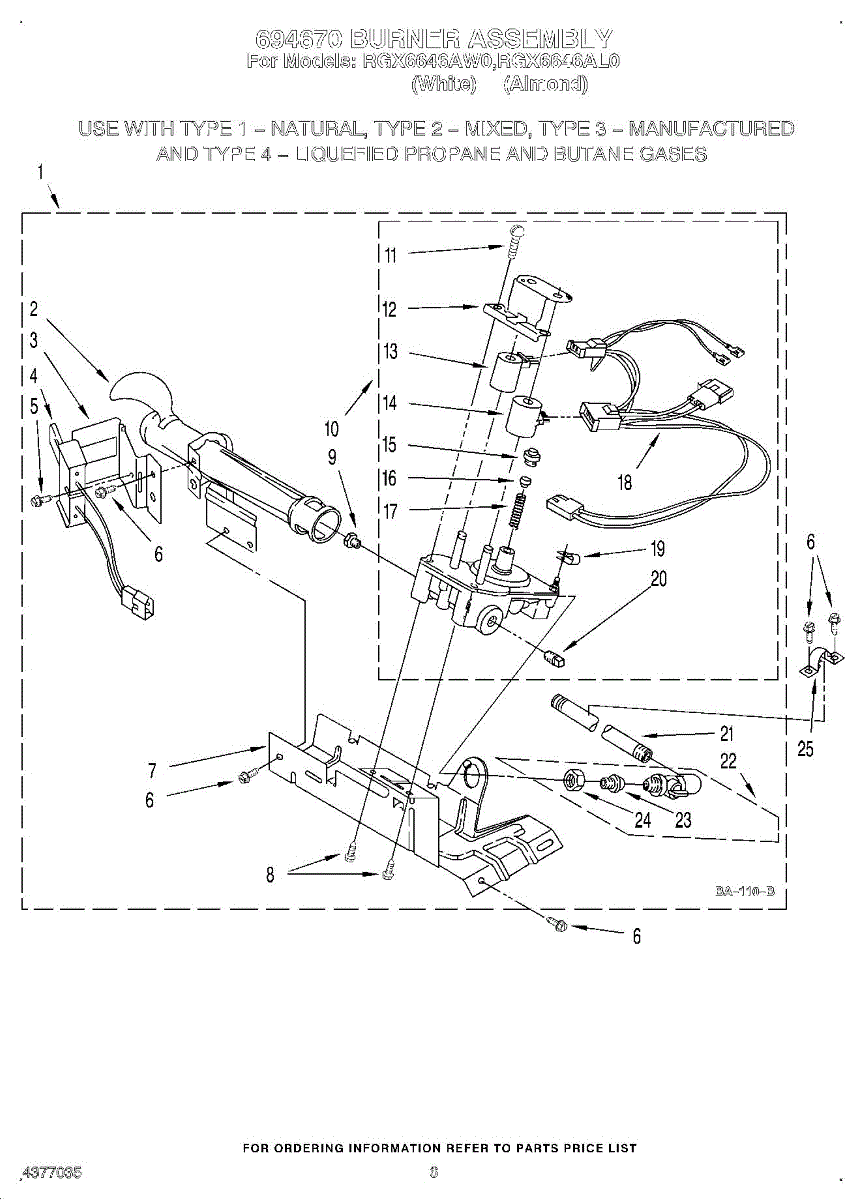

Parts for Roper RGX6646AW1: 03 - 694670 Burner Assembly Parts
