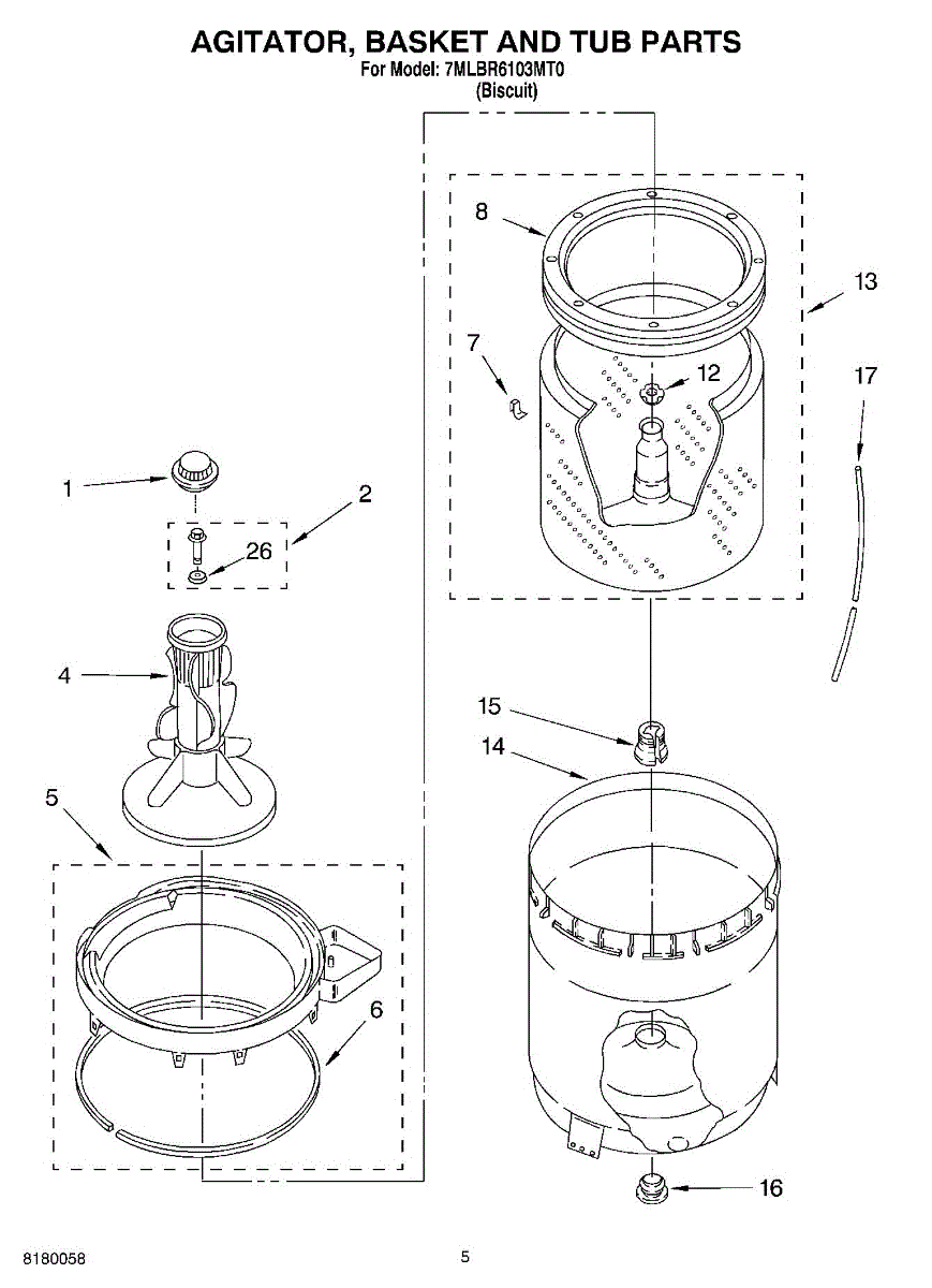

The Agitator Cap is an OEM part for Whirlpool washing machines. It fits on top of the agitator and helps secure the agitator components, ensuring proper functioning during the wash cycle. This cap is essential for maintaining the agitator's efficiency and preventing water from entering the agitator assembly.
Causes of a bad agitator cap can include wear and tear from regular use, cracking or damage from impacts, or degradation due to exposure to detergents and water over time.
Symptoms of a bad agitator cap include:
  • The cap being loose or not fitting properly
  • Water leaking into the agitator assembly
  • Excessive noise during the wash cycle
  • Reduced agitation performance

This agitator Bolt is an OEM replacement part for Whirlpool washing machines. It is a crucial component for maintaining the performance of various washing machines and washer-dryer combos. This agitator bolt secures the agitator, ensuring smooth and efficient operation. The kit includes one 7/16" screw head bolt with a rubber gasket and threaded sealant.
Causes of a faulty bolt can be damage from mineral deposits accumulation preventing smooth tightening, or wear over time compromising the threading.
Symptoms of a bad agitator bolt include:
  • Loose or wobbly agitator unable to spin freely
  • Abnormal noises or vibrations during cycles
  • Insufficient cleaning from improper agitation
  • Safety concerns if the agitator detaches entirely
This OEM replacement part is also compatible with  Inglis, Estate, Admiral, Crosley, Roper, Magic Chef, Amana, KitchenAid, Maytag, Whirlpool, and Kenmore brand models.
$8.27
$1.32
4.9 (15)
This agitator assembly is the center post in a top-load washer. It transfers drive motion to move water and fabrics, restoring proper wash action when the original agitator is cracked, stripped, or loose.
  • Oscillates in the wash basket to circulate clothes and water
  • Engages the drive shaft/splines to create agitation
  • Replaces a damaged or worn agitator to maintain wash performance
  • Common symptoms: no or weak agitation, clothes not moving, visible cracks, wobble
What's included: One agitator assembly Install notes:
  • Disconnect power to the washer before servicing
  • Remove the fabric softener dispenser and cap, then the center hold-down bolt
  • Pull the old agitator straight up; align splines and seat the new agitator, then reinstall and tighten the bolt
  • Reinstall cap/dispenser and run a short test cycle
