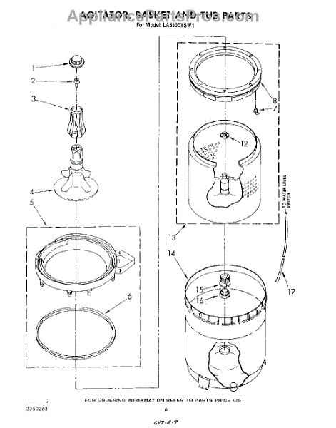

The Agitator Cap is an OEM part for Whirlpool washing machines. It fits on top of the agitator and helps secure the agitator components, ensuring proper functioning during the wash cycle. This cap is essential for maintaining the agitator's efficiency and preventing water from entering the agitator assembly.
Causes of a bad agitator cap can include wear and tear from regular use, cracking or damage from impacts, or degradation due to exposure to detergents and water over time.
Symptoms of a bad agitator cap include:
  • The cap being loose or not fitting properly
  • Water leaking into the agitator assembly
  • Excessive noise during the wash cycle
  • Reduced agitation performance
$10.43
$12.31
$1.88
5.0 (156)
This agitator Bolt is an OEM replacement part for Whirlpool washing machines. It is a crucial component for maintaining the performance of various washing machines and washer-dryer combos. This agitator bolt secures the agitator, ensuring smooth and efficient operation. The kit includes one 7/16" screw head bolt with a rubber gasket and threaded sealant.
Causes of a faulty bolt can be damage from mineral deposits accumulation preventing smooth tightening, or wear over time compromising the threading.
Symptoms of a bad agitator bolt include:
  • Loose or wobbly agitator unable to spin freely
  • Abnormal noises or vibrations during cycles
  • Insufficient cleaning from improper agitation
  • Safety concerns if the agitator detaches entirely
This OEM replacement part is also compatible with  Inglis, Estate, Admiral, Crosley, Roper, Magic Chef, Amana, KitchenAid, Maytag, Whirlpool, and Kenmore brand models.
$8.27
$1.32
Color: White. This washer lint filter is also known as the upper agitator.
$108.22
$128.78
$20.56
This is the washer's agitator assembly with a built-in filter. Replacing a worn or damaged agitator restores proper turnover of clothes and helps capture lint during the wash for cleaner results.
  • Drives the back-and-forth wash action that circulates and rolls laundry
  • Integrated filter helps collect lint and debris from wash water
  • Worn fins or a stripped hub can cause weak or no agitation and poor cleaning
  • A missing/damaged filter may lead to excess lint on clothing
What's included: 1 agitator assembly with integrated filter. Install notes:
  • Disconnect power before servicing; turn off water supply for safety.
  • Remove the softener cup/center cap; take out the center bolt or retainer if equipped.
  • Lift the old agitator straight up; align splines and press the new agitator fully into place.
  • Reinstall the fastener and cap; run a short cycle to confirm proper agitation.
$108.62
$130.34
$21.72
This tub ring seal sits between the washer's outer tub and the tub ring. It creates a splash-resistant barrier at the top of the tub to keep wash water contained and help prevent leaks from the cabinet area.
  • Seals the perimeter joint between the tub ring and outer tub
  • Helps prevent water splashes from escaping during agitation and spin
  • May help if you notice water around the lid/top of the cabinet
  • Replace when the gasket is torn, brittle, or permanently compressed
What's included: 1 tub ring seal Install notes:
  • Unplug the washer and shut off the water supply before servicing
  • Lift the top or remove the cabinet to access the tub ring (varies by model)
  • Remove the tub ring; clean mating surfaces; seat the new seal evenly without twists
  • Reassemble and run a short fill/agitate test to check for leaks
$45.95
$55.14
$9.19
This balance ring mounts on the top of the washer's spin basket. Its sealed, liquid-filled chamber shifts weight to counterbalance uneven loads so the tub spins smoothly, reducing vibration, noise, and stress on other components. What it does:
  • Uses internal fluid to counterbalance heavy or uneven loads during spin
  • Helps minimize vibration, shaking, and thumping noises
  • Reduces washer movement or "walking" during spin
  • Common failure symptoms: excessive vibration/noise, frequent out-of-balance loads, or visible cracks/leaks at the ring
  • 1 balance ring assembly
  • Disconnect power and water; wear gloves and use proper safety precautions
  • Access the ring by removing the cabinet/top and inner basket (procedure varies by model)
  • Remove the old ring; seat the new ring evenly on the basket rim—do not puncture the sealed chamber
  • Reassemble, level the washer, and run a test spin to ensure smooth operation
$104.43
$124.27
$19.84
Price Per Each
4.9 (28)
The Spanner Nut is an OEM part for Whirlpool washing machines. This nut secures the washer tub to the drive shaft, ensuring that the tub remains stable during the wash and spin cycles. Properly securing the tub is crucial for the machine's performance and longevity, as it helps maintain balance and reduce vibrations.
You should replace the spanner nut if it becomes loose or stripped. Causes of a bad spanner nut can include over-tightening, regular wear and tear, or damage from heavy loads. Exposure to moisture and detergent over time can also lead to corrosion, compromising the nut's ability to secure the tub effectively.
Symptoms of a bad spanner nut include:
  • Excessive vibrations or shaking during the wash cycle
  • Loud banging or knocking noises
  • The washer tub being loose or misaligned
  • Leaks around the tub area
Tool for removing the spanner nut - TB123B.
$1.89
This genuine OEM part is an outer tub for washers. The outer tub is the main tub where clothes are set to wash. If the tub is no longer spinning properly or is making a loud noise as it rubs against the washer, it will need to be replaced. Thankfully, replacing this part is a relatively simple process.To replace the outer tub, start by making sure the washer is unplugged. After that, remove the front panel of the washer. Once removed, lift up the top panel so that it is no longer covering the outer tub. Next, locate the mounting bolts that secure the tub and unthread them using a socket wrench. Once removed, lift the tub out from the washer. Replace with the new tub and secure the mounting bolts. Reinstall the front panel and plug the washer back in. This replacement part is sold individually and is compatible with Whirlpools, Maytag, Kitchenaid, Jenn-Air, Amana, Magic Chef, Admiral, Norge, Roper, and Sears/Kenmore brand washers.
4.8 (89)
The Washer Drive Block is an OEM part for Whirlpool washing machines. This component is situated between the washer's transmission and the inner tub, playing a key role in transferring the rotational motion from the motor to the tub.
Causes for replacement often stem from normal wear and tear, which can lead to the drive block becoming worn or damaged. This wear can prevent the drive block from properly engaging with the tub, leading to inefficient cycles and potential damage to other parts of the washing machine.
Symptoms of a bad Washer Drive Block include:
  • The washer tub has difficulty agitating or spinning.
  • A loud noise during the spin cycle, indicating that the tub is not engaging correctly with the transmission.
  • The machine vibrates excessively or seems off-balance, even with a balanced load.
$18.95
$22.74
$3.79
4.8 (78)
The Centerpost Gasket is an OEM replacement part for Whirlpool washers. This component serves as a vital seal around the center post or agitator shaft, preventing water leaks and ensuring proper operation during wash cycles.
Symptoms of a failing centerpost gasket may include:
  • Water leaking from the top or bottom of the washer tub
  • Excessive moisture buildup around the agitator area
  •  Potential mold or mildew growth due to leaks
Causes of needing to replace the centerpost gasket can include normal wear and tear over extended use, damage or deterioration from exposure to heat or chemicals, or physical tearing or displacement of the gasket material.
This OEM part is also compatible with Maytag, KitchenAid, Jenn-Air, Amana, Magic Chef, Admiral, Norge, Roper, and Kenmore washer models.
$9.54
$1.59
This is a clear plastic hose that runs from the water level switch to the bottom of the tub.
The Water Level Pressure Switch Hose is an OEM part for Whirlpool washers, playing a critical role in the accurate measurement of water levels within the machine.
Causes of damage to the Water Level Pressure Switch Hose can stem from natural wear and tear over time, leading to cracks or holes in the hose.
Symptoms of a bad Water Level Pressure Switch Hose include:
  • The washer overfills or underfills, indicating a problem with water level detection.
  • Unusual noises during the fill cycle, which may suggest air leaks in the hose.
  • Error codes related to water level or filling issues displayed on the washer.
  • The machine stops mid-cycle due to incorrect water level readings.
$47.95
$57.06
$9.11
