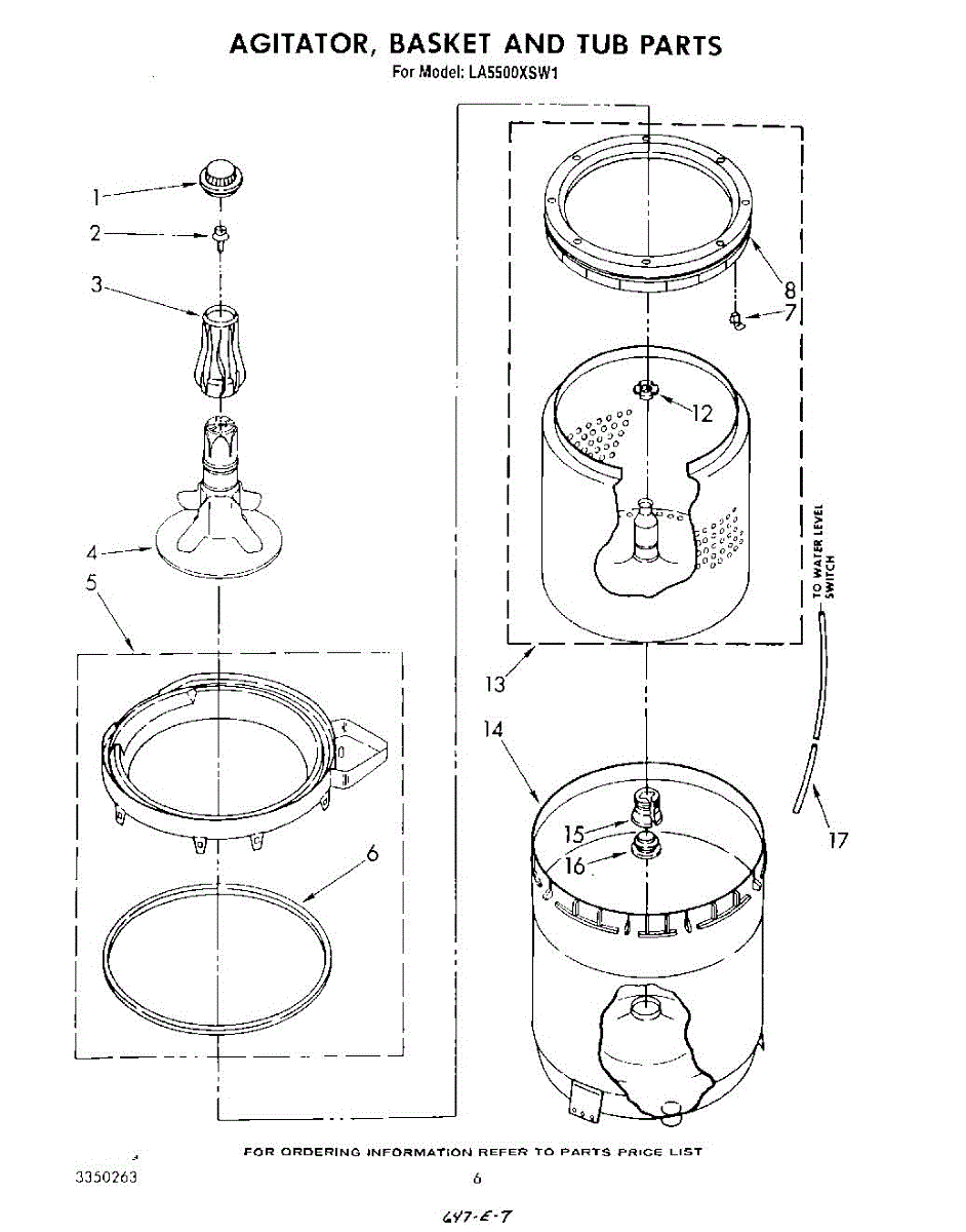

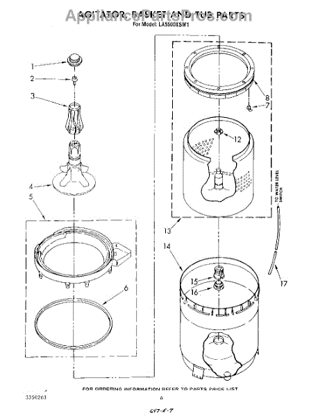

Parts for Whirlpool LA5500XSM1: 04 - Agitator, Basket And Tub Parts
