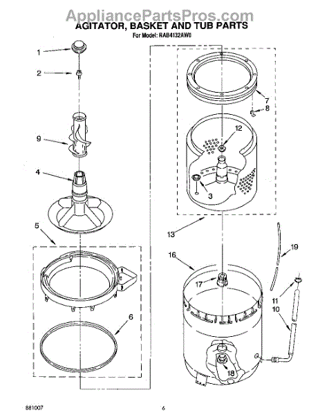

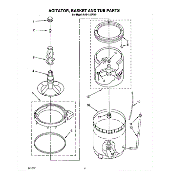

Parts for Whirlpool RAB4132AL0: 05 - Agitator, Basket And Tub Parts
