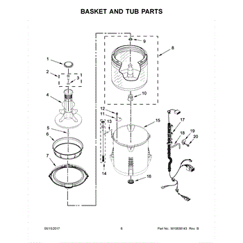

This agitator cap snaps into the top of the washer's agitator to seal the center opening and cover the retaining bolt. Replacing a cracked or missing cap helps keep water out of the agitator and maintains a clean, finished look. What it does:
  • Seals the agitator's center opening to keep water, detergent, and debris out
  • Protects the center bolt/drive hub area from moisture intrusion
  • Restores proper fit and appearance when the original cap is cracked, warped, or missing
  • Common symptoms: cap won't stay on, visible cracks, water found inside the agitator, rattling/sloshing from trapped water
  • 1 agitator cap (black)
  • Unplug the washer before servicing
  • If equipped, pull off the fabric softener dispenser to access the cap
  • Lift or gently pry out the old cap; clean the mating surface
  • Align and press the new cap firmly until fully seated and flush
The Washplate Bolt is an OEM part for Whirlpool washing machines. This bolt is designed to secure the washplate to the washer's drive shaft, ensuring stable and effective agitation during the wash cycle.
Causes of a bad washplate bolt can include stripping or wearing out from regular use, corrosion from exposure to water and detergents, or damage due to over-tightening or improper installation. A faulty bolt can compromise the washplate's stability and affect the washing machine's performance.
Symptoms of a bad washplate bolt include:
  • The washplate being loose or wobbling during operation
  • Unusual noises such as rattling or clunking during the wash cycle
  • Poor cleaning performance due to ineffective agitation
  • The washplate detaching from the drive shaft

The Agitator Bolt Washer is an OEM part for Whirlpool washing machines. It sits beneath the agitator bolt, providing a secure and tight seal to ensure the agitator remains firmly attached to the drive shaft. This washer plays a crucial role in the smooth and effective operation of the agitator during the wash cycle.
You should replace this agitator bolt washer if it becomes worn out, cracked, or lost. Causes of a bad washer can include regular wear and tear, exposure to harsh detergents, or high levels of agitation that can degrade the material over time.
Symptoms of a bad agitator bolt washer include:
  • The agitator being loose or wobbling during the wash cycle
  • Unusual noises coming from the agitator area
  • Ineffective washing performance
  • The agitator not staying in place

The straight-vane agitator is the finned center post that drives wash action in a top-load washer. It replaces a cracked or stripped agitator to restore proper clothes movement and consistent cleaning performance. What it does:
  • Mounts on the drive shaft and oscillates to move laundry through wash water and detergent
  • Restores wash action when vanes are broken or the internal splines are worn/stripped
  • Helps address weak agitation, clothes not circulating, unusual rattling from a loose agitator, or visible damage
  • Direct replacement for the original straight-vane agitator design
  • 1 straight-vane agitator
  • Disconnect power and turn off water before servicing
  • Remove the center cap and hold-down bolt; lift the old agitator straight up
  • Align splines, seat the new agitator, then reinstall the bolt and cap snugly
  • Run a short cycle to ensure proper operation

The Balance Ring Adapter is an OEM part for Whirlpool washing machines. This part helps stabilize the washer drum during the spin cycle, ensuring smooth and balanced operation. This adapter connects the balance ring to the drum, helping to distribute weight evenly and reduce vibrations and noise.
Causes of a bad Balance Ring Adapter can include wear and tear from regular use, physical damage from overloading the washer, or degradation over time due to constant movement and stress.
Symptoms of a bad Balance Ring Adapter include:
  • Excessive vibrations or shaking during the spin cycle
  • Loud banging or thumping noises coming from the washer
  • The washer moving or "walking" during operation
  • Imbalance errors or the washer stopping mid-cycle due to uneven weight distribution

This tub ring, also called the tub cover or splash ring, snaps around the top of the wash basket to contain water and suds. Replacing a cracked ring helps stop over-the-rim leaks and protects fabrics from rough edges.
  • Acts as a splash guard at the rim to keep wash water and suds inside during wash and spin
  • Provides a smooth upper edge to help prevent fabric snagging on broken plastic
  • Restores a secure seal at the tub opening when the original ring is cracked or warped
  • Typical signs of failure: water splashing or leaking from the top, visible cracks, or the ring not locking firmly to the tub
What's included: 1 tub ring Install notes:
  • Open the top/console as required by your model to access the tub opening
  • Release the old ring's locking tabs; transfer any attached retainers/hoses to the new ring if present
  • Seat the new ring evenly and snap all tabs fully into place; run a quick test to check for leaks
Note: This is the plastic splash ring at the tub rim—not the sealed balance ring counterweight.

The Spanner Nut is an OEM part for Whirlpool washing machines. This nut secures the washer tub to the drive shaft, ensuring that the tub remains stable during the wash and spin cycles. Properly securing the tub is crucial for the machine's performance and longevity, as it helps maintain balance and reduce vibrations.
You should replace the spanner nut if it becomes loose or stripped. Causes of a bad spanner nut can include over-tightening, regular wear and tear, or damage from heavy loads. Exposure to moisture and detergent over time can also lead to corrosion, compromising the nut's ability to secure the tub effectively.
Symptoms of a bad spanner nut include:
  • Excessive vibrations or shaking during the wash cycle
  • Loud banging or knocking noises
  • The washer tub being loose or misaligned
  • Leaks around the tub area
Tool for removing the spanner nut - TB123B.
