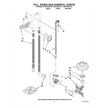

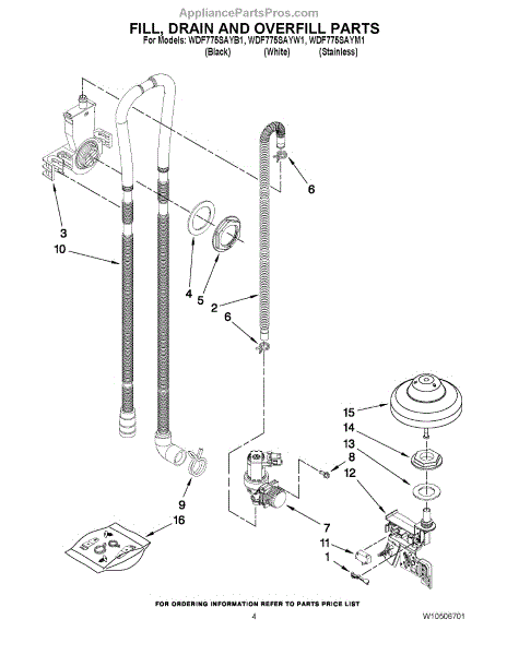

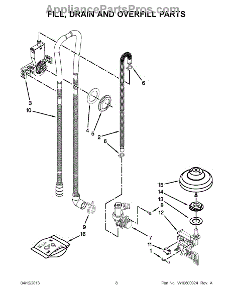

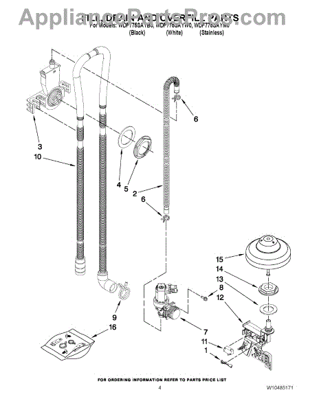

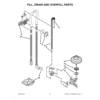

Parts for Whirlpool WDF750SAYM3: 05 - Fill, Drain And Overfill Parts
