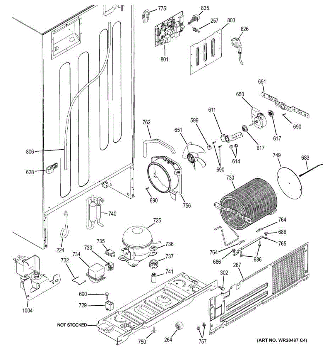

Parts for Ge PTS25LHSCRWW: 09 - Sealed System & Mother Board Parts

The Condenser Fan Motor is an OEM part for GE refrigerators. This fan motor circulates air in the fridge, helping to cool the compressor and condenser coils for better temperature control. It also evaporates extra water in the drain pan, stopping problems from water buildup.
Symptoms of a failing condenser fan motor include:
  • The refrigerator running hotter than usual
  • Loud noise or rattling sounds coming from the back of the refrigerator
  • The refrigerator cycling on and off more frequently or for longer periods
Causes of condenser fan motor failure typically include wear and tear from continuous use, dust and debris accumulation obstructing fan movement, or electrical issues such as faulty wiring or capacitor problems.
Note: This is a (12-volt DC) fan motor. For the (115-volt AC) fan motor, order part number WR60X10220.
$73.95
$88.00
$14.05
651
The Condenser Fan Blade is an OEM part for GE refrigerators. It is responsible for moving air across the condenser coils to help dissipate heat, allowing the refrigerator to maintain the proper cooling temperature. This fan blade ensures efficient operation of the cooling system by facilitating proper airflow.
You should replace this condenser fan blade if it becomes damaged, warped, or fails to move air effectively. Common causes of a bad fan blade include physical damage from debris, wear and tear over time, or warping due to prolonged exposure to heat.
Symptoms of a bad condenser fan blade include:
  • Refrigerator not cooling properly
  • Increased noise from the refrigerator
  • Overheating of the condenser coils
  • Reduced airflow around the condenser area

The Run Capacitor is an OEM part for GE refrigerators. It plays a crucial role in the refrigerator's cooling system by providing the necessary start and run voltage to the compressor. Without a properly functioning run capacitor, your refrigerator may struggle to maintain the desired temperature, leading to spoiled food and inefficient energy use.
Causes of a bad run capacitor include electrical surges, wear and tear over time, or overheating due to a malfunctioning refrigerator compressor or poor ventilation.
  • The refrigerator compressor fails to start.
  • Unusual humming noises coming from the refrigerator.
  • The refrigerator cycles on and off more frequently than normal.
  • A noticeable increase in energy consumption as the refrigerator struggles to maintain the proper temperature.

This condenser assembly is the condenser coil used in compatible refrigerators to release heat from the refrigerant so the appliance can cool efficiently. Replacing a damaged coil helps restore proper cooling performance and energy use. What it does:
  • Circulates refrigerant through the condenser coil to dissipate heat from the refrigeration system
  • Supports normal compressor cycling and helps maintain steady internal temperatures
  • Common symptom fixes: reduces long run times, improves inadequate or uneven cooling, and addresses overheating or noisy compressor operation
  • Works with the condenser fan and other sealed-system components to complete the heat-exchange process

This PTC start relay mounts on the refrigerator compressor and briefly energizes the start winding, then automatically opens as it warms. Replacing a weak relay helps restore reliable compressor starts and consistent cooling. What it does:
  • Provides momentary power to the compressor's start winding at startup; the PTC element opens as it heats
  • Helps ensure smooth compressor starts and reduces repeated start attempts
  • Signs of a failed start device can include no cooling because the compressor won't run
  • Clicking or buzzing from the compressor area every few minutes
  • Compressor starts intermittently or stops shortly after starting
  • Includes: 1 PTC start relay
  • Disconnect power and pull the refrigerator forward to access the rear service area
  • Remove the rear panel to reach the compressor compartment
  • Unplug the wire harness and pull the old relay straight off the compressor terminals; note its orientation
  • Push the new relay fully onto the compressor prongs, reconnect the harness, reinstall the panel, and restore power

This compressor overload protects the refrigerator's compressor by interrupting power when it overheats or draws excessive current. Replacing a weak or failed overload can stop repeated click/no-start symptoms and help restore normal cooling performance.
  • Opens the circuit to protect the compressor during overheat or over-current conditions
  • Automatically resets after cooling to prevent sustained damage
  • Symptoms include: compressor won't start, rapid clicking from the compressor area, starts then stops, and a warm refrigerator/freezer
  • Helps prevent motor and wiring damage caused by repeated overload events
What's included: One compressor overload. Install notes:
  • Disconnect power before servicing; wear appropriate PPE
  • Access the rear machine compartment and remove the compressor/start device cover
  • Note wire positions; pull the old overload straight off the compressor terminal and push the new one on fully seated; reconnect wiring and covers
  • If the overload trips again after replacement, further diagnosis of the start relay, run capacitor, or compressor may be required

This condenser shroud is the plastic cover that protects and channels airflow around the refrigerator condenser, helping the cooling system run efficiently and keeping components shielded from debris. What it does:
  • Directs airflow over the condenser coils to help dissipate heat
  • Protects condenser and nearby components from dust, pet hair, and accidental contact
  • Helps maintain proper clearance and airflow paths behind the fridge
  • Can reduce vibration noise by stabilizing condenser area
  • One condenser shroud/cover
  • Designed to mount in the condenser compartment; follow your model's service manual for correct orientation and fasteners
  • Disconnect power to the appliance before accessing the condenser area to avoid electrical shock
  • Inspect and clean condenser coils while the shroud is removed for best performance
  • If clips or screws are damaged, replace them with OEM-recommended hardware

This 10-32 x 1/2 machine screw secures appliance components where a standard 10-32 fastener is required. It restores proper mounting and reduces vibration or loose panels for reliable, quiet operation. What it does:
  • Secures panels, brackets, or components that use a 10-32 threaded hole
  • Prevents rattling, misalignment, and intermittent contact caused by loose fasteners
  • Maintains electrical or mechanical connections when used as the OEM-specified screw
  • Helps restore fit and finish after repair or disassembly
What's included: One 10-32 x 1/2 machine screw Install notes:
  • Use the correct 10-32 driver (Phillips or slotted depending on head) and hand-start the screw to avoid cross-threading
  • Tighten until snug; avoid over-tightening to prevent stripping threads or cracking plastic parts
  • Replace only with the same size and thread spec to ensure proper fit
  • Disconnect power if working near energized components or wiring
$6.72
$1.64
762

801
4.9 (454)
The Board Asm Main Control is an OEM replacement part for GE refrigerators. It serves as the electronic brain of the appliance, controlling and coordinating all the essential functions and operations of the refrigerator.
Causes of a bad refrigerator main control board can include electrical malfunctions, power surges, or physical damage due to moisture or impact over time.
Symptoms of a bad main control board include:
  • The refrigerator not powering on or responding to user inputs
  • Inconsistent temperature regulation or cooling performance
  • Error codes or fault indicators displayed on the control panel
  • Individual components or systems, like the ice maker or defrost cycle, not functioning properly
$304.30
$327.19
$22.89
803
806
4.7 (19)
The Ice Maker Water Line is an OEM replacement part for GE refrigerators. It is an important supply line that delivers water from the main water source to the icemaker component. The water line allows water to flow smoothly, facilitating the icemaking process.
Causes of a bad water line can include cracks or punctures from impact or bending, mineral deposits and corrosion building up inside the line restricting flow, or improper connection fittings causing leakage.
Symptoms of a bad ice maker water line include:
  • Irregular or insufficient ice production
  • No water delivery to the icemaker despite activation
  • Noticeable leaks or drips near the water line attachment points
  • Strange knocking or hammering sounds are heard when the icemaker is running
$10.56
$1.61
835
$15.27
$17.77
$2.50
1004
4.9 (434)
The Water Valve with Guard is an OEM part for GE refrigerators, responsible for controlling the flow of water to the ice maker and water dispenser. This part ensures that your refrigerator dispenses fresh, clean water and ice on demand.
Symptoms of a bad Water Valve with Guard include:
  • No water being dispensed
  • A slow or irregular flow of water
  • The ice maker not producing ice
Causes of failure can range from mineral deposits clogging the valve, electrical failures preventing the valve from opening or closing correctly, or physical damage to the valve.
$86.49
$102.92
$16.43
