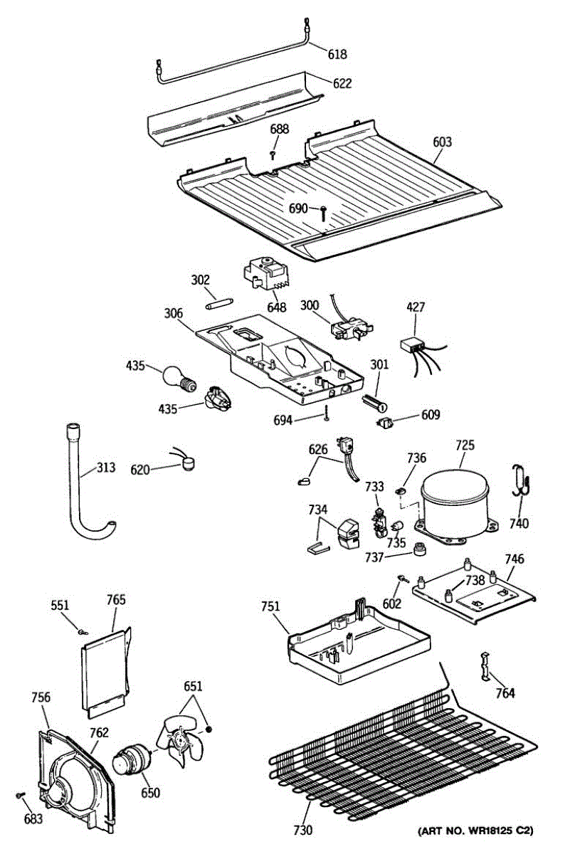

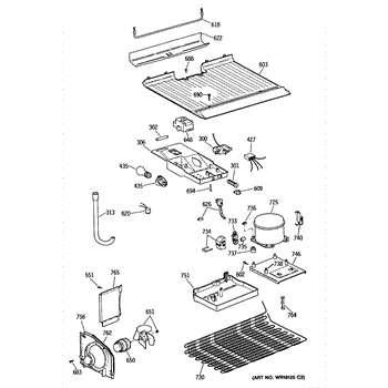

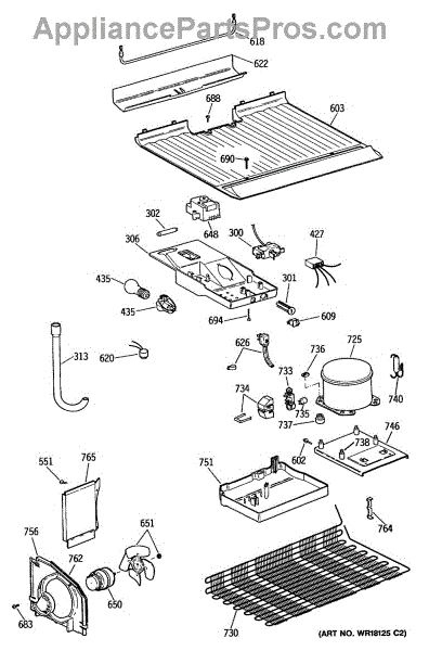

Parts for Ge CTE16EYTBRWH: 03 - Section3 Parts

4.9 (22)
The Light Socket is an OEM part for GE refrigerators. It is responsible for holding the refrigerator's light bulb and ensuring it receives power to illuminate the interior when the door is opened.
You should replace the light socket if it becomes faulty. Causes of a bad light socket can include wear and tear from regular use, electrical issues such as short circuits or power surges, and corrosion from moisture exposure.
  • The refrigerator light not turning on when the door is opened
  • Flickering or intermittent light operation
  • The light bulb not fitting securely or falling out
