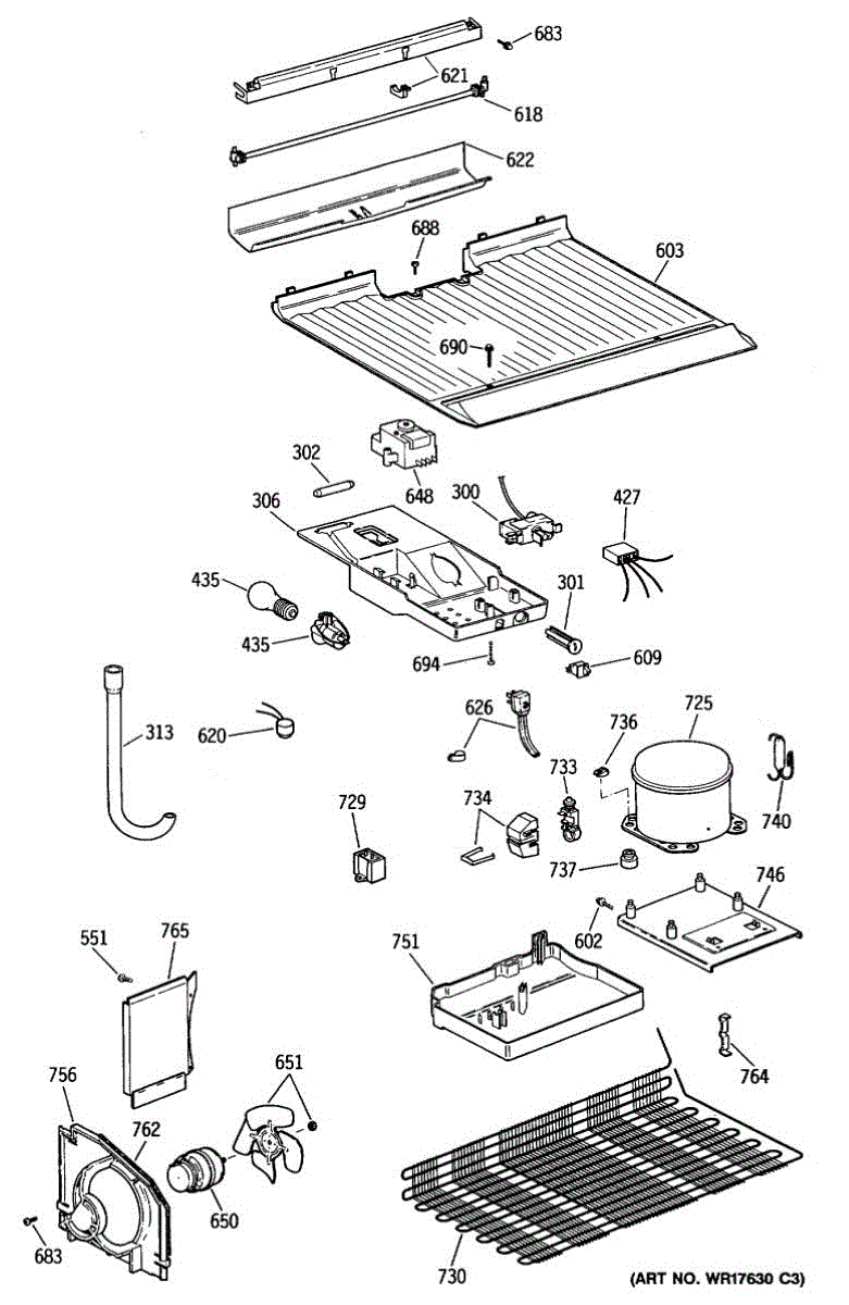

The Light Socket is an OEM part for GE refrigerators. It is responsible for holding the refrigerator's light bulb and ensuring it receives power to illuminate the interior when the door is opened.
You should replace the light socket if it becomes faulty. Causes of a bad light socket can include wear and tear from regular use, electrical issues such as short circuits or power surges, and corrosion from moisture exposure.
  • The refrigerator light not turning on when the door is opened
  • Flickering or intermittent light operation
  • The light bulb not fitting securely or falling out

The Light Switch is an OEM replacement part for GE refrigerators. It controls the interior light, turning it on when the refrigerator door is opened and off when the door is closed. This ensures proper illumination for visibility when accessing the refrigerator's contents.
A malfunctioning light switch can result from wear and tear, electrical issues, or damage caused by repeated use. Over time, the internal mechanism may fail, or the housing can crack, leading to improper operation.
Symptoms of a bad light switch include:
  • Interior light not turning on when the door is opened
  • Light staying on even when the door is closed
  • Flickering or inconsistent light operation
  • Difficulty pressing or releasing the switch

This defrost heater and bracket assembly mounts at the evaporator and melts frost during the automatic defrost cycle. Restoring airflow across the coils helps bring temperatures back to normal and keeps your refrigerator cooling efficiently.
  • Heats the evaporator during defrost to clear frost and ice buildup
  • Helps prevent heavy frost on the freezer back wall and improves airflow
  • Supports stable refrigerator and freezer temperatures
  • Failure symptoms include thick frost on the evaporator cover, warmer fresh-food section, evaporator fan hitting ice, or frequent manual defrosting

This defrost thermostat monitors evaporator temperature and controls power to the defrost heater, shutting it off at the correct point in the cycle. Replacing a failed thermostat helps clear frost and restore stable cooling and airflow.
  • Senses evaporator coil temperature in the freezer
  • Closes when cold to allow the defrost heater to run; opens as the coil warms to terminate defrost
  • Helps prevent excessive frost buildup and maintains proper airflow
  • Typical failure signs: heavy frost on the evaporator/back wall, weak airflow, warm fresh-food section, unit runs constantly or never defrosts

This cable clamp secures refrigerator wiring to the cabinet, keeping harnesses organized and protected. Replacing a missing or damaged clamp helps prevent chafing and vibration noise while maintaining proper clearance from fans and other moving components.
  • Anchors wire harnesses in their designed routing
  • Helps prevent insulation wear from rubbing or vibration
  • Keeps wires clear of sharp edges and moving parts
  • Common signs it's needed: missing/broken clamp, loose or dangling wires, or new rattling/buzzing noises

This power cord assembly supplies electrical power from the wall outlet to your refrigerator. Replace a cut, frayed, or overheated cord to restore safe, reliable operation and eliminate intermittent power loss caused by a damaged cord. What it does:
  • Provides the electrical connection between the household outlet and the refrigerator's wiring
  • Helps resolve no-power or intermittent power when the cord is moved
  • Addresses visible damage such as cuts, cracks, fraying, or a melted/discolored plug
  • Mitigates arcing, sparking, or a burning odor originating from the cord or plug area

The Defrost Timer is an OEM part for GE refrigerators. This part manages the defrost cycle of the fridge and freezer compartments, ensuring that the evaporator coils do not build up excessive frost.
This cycling is crucial for maintaining optimal temperatures for food preservation and energy efficiency. Over time, the defrost timer can malfunction due to wear, electrical issues, or a buildup of dust and debris, leading to poor performance or failure.
Symptoms of a bad Defrost Timer include:
  • Frost buildup in the freezer compartment
  • The refrigerator or freezer is not maintaining the set temperature
  • The fridge or freezer sections are too warm
  • The defrost cycle does not activate, leading to reduced cooling efficiency

The Condenser Fan Motor is an OEM part for GE refrigerators. It is designed to circulate air through the condenser coils, helping to dissipate heat and keep the refrigerator's internal components cool. This ensures efficient operation and prevents the compressor from overheating, which is essential for maintaining the refrigerator's performance and longevity.
You should replace the condenser fan motor if it becomes faulty. Causes of a bad fan motor can include electrical failures, wear and tear from regular use, or blockages that cause the motor to overheat or burn out. A malfunctioning fan motor can lead to inadequate cooling, increased energy consumption, and potential damage to other refrigerator components.
Symptoms of a bad condenser fan motor include:
  • The refrigerator not cooling properly
  • Unusual noises coming from the back of the refrigerator
  • The compressor running hot or cycling on and off frequently
  • The condenser coils feeling excessively hot
