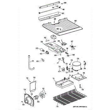

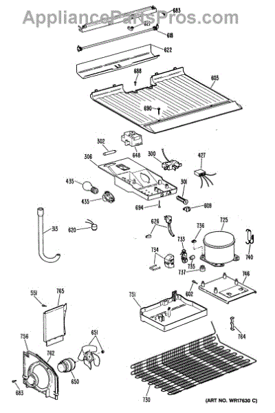

Parts for Ge CTX16CYSDLAD: 03 - Section3 Parts
